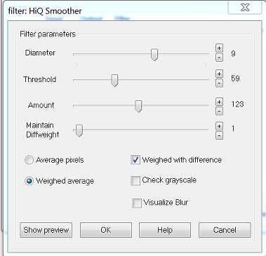

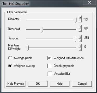

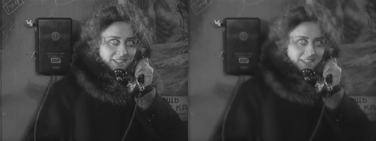

  1. I have used VirtualDub SmoothHiQ.vdf on very poor quality webcam with acceptable results.
    Settings used range from: SmoothHiQ(9,59,128,"weighted")
    First Image: SmoothHIQ Setting 1.jpg
    To: SmoothHiQ(13,60,254,"weighted")
    Second Image: SmoothHIQ Setting 3.jpg

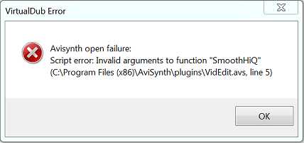

  4. VirtualDub Error Message
Name:	SmoothHIQ Error.jpg
  5. Try naming the filter when you load the plugin. Then call the filter by that name.
    LoadVirtualDubPlugin(C:\Program Files (x86)\AviSynth\plugins\SmoothHiQ.dll","vdub_SmoothHiQ")
    WhateverSource("filename.ext")
    ConvertToRGB32()
    vdub_SmoothHiQ(13, 60, 0, 254, 1, 0, 1, 0)
    Also, make sure you use all 32 bit components or all 64 bit components. For example, 32 bit AviSynth, 32 bit VirtualDub filters, 32 bit editor/encoder.

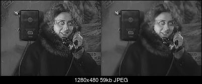

  7. It works for me with 8 arguments:
    LoadVirtualdubPlugin("G:\Program Files\Virtualdub\plugins\SmoothHiQ.vdf", "vdub_SmoothHiQ")
    AviSource("aelita.avi")
    ConvertToRGB32(matrix="rec601")
    StackHorizontal(last, vdub_SmoothHiQ(13, 60, 0, 254, 1, 0, 1, 0))
    ConvertToYV12(matrix="rec601")
    Maybe you have a different version? Mine is very old (I don't use AviSynth for filtering or encoding anymore), from 2002.

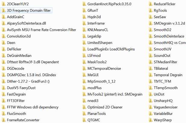

    Here are folders I made and downloaded plugins for, the version numbers will be for another day.
    It is not meant to be an all inclusive list, but Let me know if you have suggestions.
