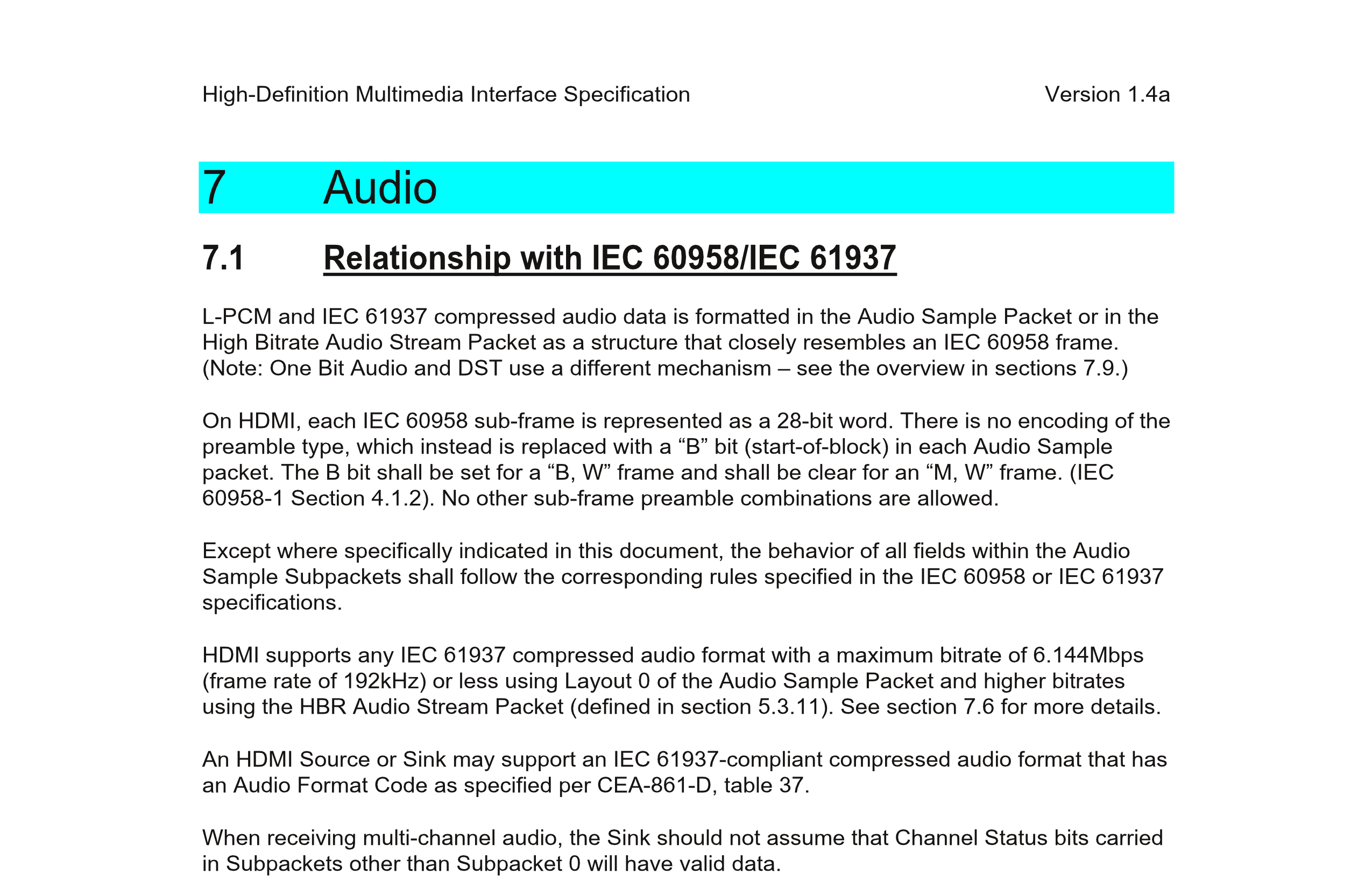

  6. Originally Posted by jan5678 View Post
    Does the hdmi specs even support AAC?
    I can't find any info regarding this.
    Afaik hdmi supports bitstream or lpcm up to 8 channels, but there's no mention of AAC
    Excerpt from HDMI specification:
    [Attachment 43610 - Click to enlarge]
    It ultimately makes no difference whether hdmi carries aac or not.
    Maybe for this particular case but for sure not in overall context - compressed stream may have more than 8 channels.
    Only other difference is decoder algorithm, and it is very likely that the aac decoder in your computer is noticeably better quality than the one in your tv.
    Sorry but it is very unlikely that PC AAC decoder is better than embedded in TV (or generally consumer electronic).

  8. Originally Posted by Cornucopia View Post
    From a straight datarate constraint, that's BS and you know this. 24bit lpcm × 192kHz = 4.5Mbps. Even with 200 channels that doesn't come close to the bandwidth of Hdmi. Long before it hits that point, other constraints would kick in elsewhere.
    Audio is sent only in very limited time slots (during H and V Blank time) - to sent audio sometimes you need to force HDMI weird modes (like pixel repetition modes) this is dirty hack. Side to this HDMI standard define particular limitation and any HDMI compliant sink or source must follow those limitations.
    You can't transmit over HDMI more than 8xLPCM 192kHz - any faster sample rate or more channels are against standard - such audio's must be encapsulated within IEC 61937.
    Embedded decoders might be more compliant, but just like scalars, what you can do in software can far surpass what you can do in embedded firmware, which often has memory-, calculation-, and update/improvement constraints.
    Funny... there is no hard-coded AAC decoder (AFAIK) - all "HW" are DSP based with quite commonly possibility to update code. Problem is fact that Windows (most popular OS) but also other popular OS are not Real Time OS, they suffer from unavoidable limitations related to their nature.
    Embedded decoders are Real Time, they provide predictable behaviour, side to this they are better tested and usually more complaint (frequently also more flexible and capable).
