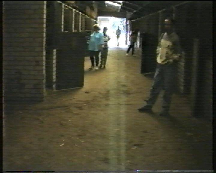

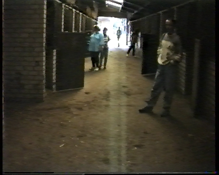

    Hi everyone, I am capturing VHS to my laptop, using a JVC HR-S8500 with TBC, capturing via Easycap with SVHS for video, and using Virtualdub to save the capture as an AVI compressed with Lagarith, before I filter the capture in Avisynth and save as a deinterlaced H264 MP4.

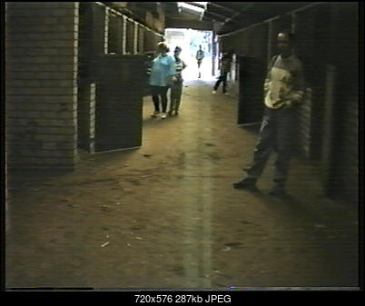

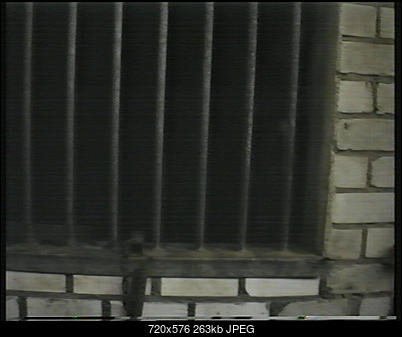

    During my capture I noticed 2 types of noise:
    Horizontal lines (see the shadows)
    Blocks (see the floor)
    You can download the video fragment here.

    You could try using a different s-video cable, but those look like problems in the recording. I'm sure jagabo will be along in a few minutes to share some Avisynth wizardry with you.
  3. Defreq() in AviSynth should be able to reduce the stripes. But I don't know how to use it.
    http://www.avisynth.nl/users/fizick/defreq/defreq.html

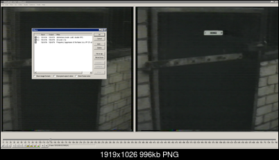

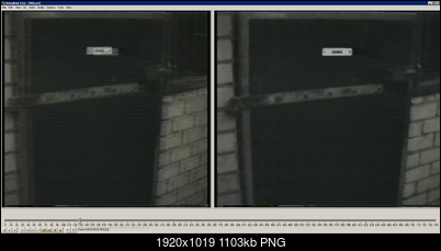

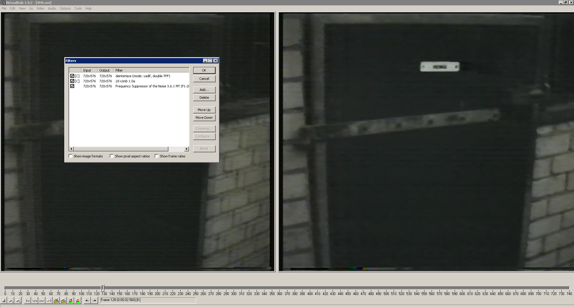

  4. You can try my method in Virtualdub using the `2D Comb Filter` and `Frequency suppressor of the noise`
    Tweak the Frequency suppressor settings to around 20 for each level setting or you lose too much detail.
    BTW You mentioned that Huffyuv compresses better than Lagerith but this is quite the opposite (your sample file is Lagerith)

    You can also try a method i learned from Jagabo where you resize down by half or 25% then resize back up
    the image gets a bit more softer and noiser but the lines do get fainter etc.

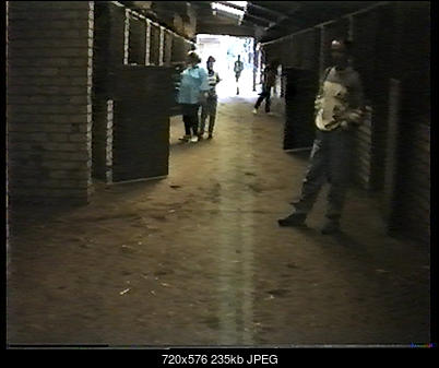

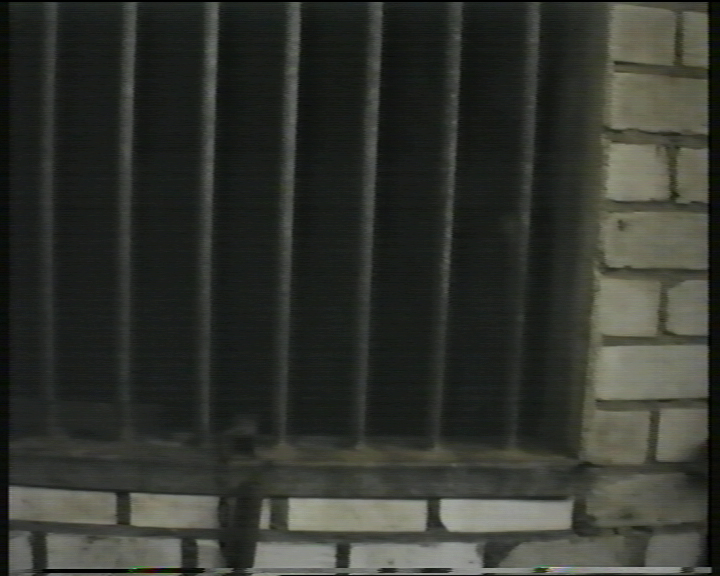

    Thank you for your great suggestions. I played around with some of the filters and got some tradeoff effects, so losing some quality. After hours of testing I remembered my old capture device, the Envivo VHS to DVD Maker, of which I found the drivers that still work in Windows 10 here: https://www.teknihall.be/en/downloads/envivo/1335
    After comparing, it seems that the Easycap device introduced the horizontal lines and blocky artefacts, as the Envivo capture is clean:
    Easycap capture
    Envivo capture
    Afterwards I adjusted the capture filter to lighten up the Envivo capture, and then I was really happy with the outcome!
    Then I captured Huffyuv, with YUY2 (in capture pin), but now I cannot open the files in Avisynth and gives me the error "avisource couldn't locate a decompressor for fourcc hfyu". This confuses me, as VirtualDub has no problems. Would you have advice how to fix this? I use the 64 bit version of huffyuv, with 64bit virtualdub, AviSynth_260. Thanks!
  7. Make sure you use all 32 bit or all 64 bit versions of each piece of software in the AviSynth chain. For example, use 32 bit AviSynth, 32 bit AviSynth filters, 32 bit codecs, and a 32 bit editor/encoder. The 32 bit and 64 bit subsystems are completely separate and cannot see each others' components.
    And your ezcap capture is probably closer to the original video than the other device. You just have to know how to deal with interlaced video.
