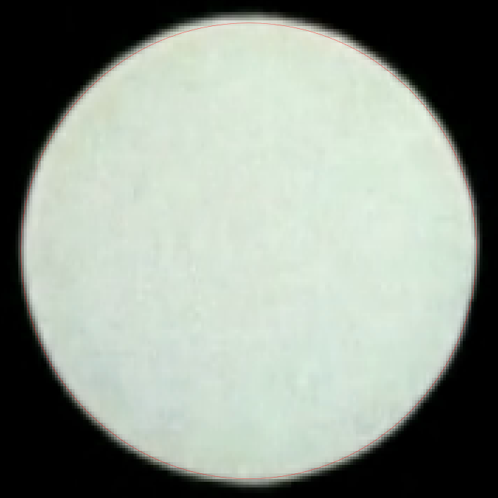

I recorded movie from TV. It is Full HD 1920x1080. The aspect ratio of movie 1,85 according to imdb.com (1920x1038) <- measured in Krita without black bars, that are part of video. I should add that I did measure on source frame, not at the screen frame. The difference between 1920x1038 and 1,85 is meaningless -2,890173410404624e-4 so the difference in percents is 0,015625%. But when I take a picture what I supposed to be perfect circle, its height is 1329 and width 1297 (when 4x resized) That is small but noticeable at circle at least. In fact it is almost 2,5% difference. That makes 25 lines less than 1038.

Thank you Jagabo for reply, it is well known movie. I dont want break rules. Is there some time limit for duration that it is o.k. ?
Meanwhile i upload the picture with circle (and with real circle on it).

I don't see any reason to believe that white circle should be a perfect circle. Even the matte that they used with it doesn't fit.
I encoded it in handbrake, I post mediainfo of original file. But I know it is 16/9. But black bars are in video. If you measured picture i uploaded, then you get something around 1918/1038-9 which is almost 1,85 (it is about tenth of percent something like 100,1%). But when measure circle then I got 2% difference height / width. That is the question. In clip I posted are black bars hidden, as edited earlier.

Hi Jagabo,
it should be, because it is gunpoint. And I don't know why they would do it taller.
Thank you
BernixLast edited by Bernix; 2nd Nov 2017 at 09:30. Reason: squeezed is probably wrong word, but don't know right one word. Taller will be right one.
I must admit, I was wrong. I just checked circle (small (r)) from company title. And it was wider than taller 61/59 but it is so tiny and so antialiased, so it is possibly wrong measure. It is shame, that they cant do a circle (gunpoint) probably some psychology is in it. But then, what can be good reference. Tire hardly if not shot accurate. I don't really know what can then be reference.

That clip isn't very clear. Is it upscaled SD? 2.5 percent is about the difference between rec.601 (704) and MPEG (720) scaling.
No, the clip wasn't converted. It was still 1920x1080. I don't think also it is resized from SD, at the end there is notice it is digitally remastered version. But the bandwidth of DVB-T isn't best. It is about 5000 kb/s h264. But it doesn't matter. Original according to imdb.com it was shot in 1,85:1 ratio, and it is. The measure is complicated but gives results about 102,something to 103 +/-.
