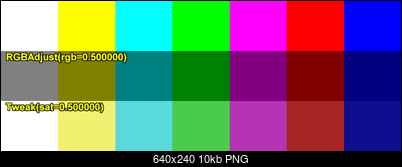

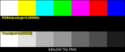

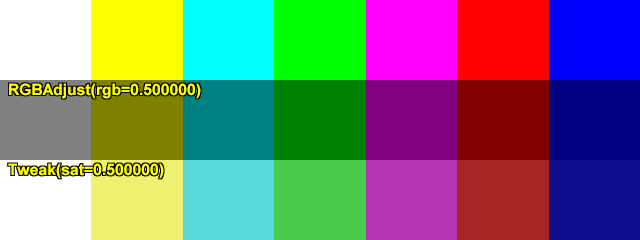

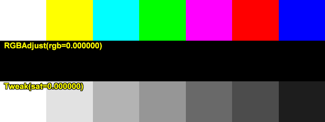

  6. Originally Posted by hello_hello View Post
    RGBAdjust would probably do the equivalent of adjusting the saturation
    RGBAdjust(0.75, 0.75, 0.75)
    That darkens the picture and is very different from a 0.75 saturation adjustment. Try this script:
    function RGBSat(clip c, float val)
       RGBAdjust(c, r=val, g=val, b=val)
       Subtitle("RGBAdjust(rgb="+String(val)+")")
    function YUVSat(clip c, float val)
       Tweak(c, sat=val)
       Subtitle("Tweak(sat="+String(val)+")")
    src = ColorBars().Crop(0,0,640,80).Trim(0,100).RGBAdjust(r=2.0, g=2.0, b=2.0, rb=-100, gb=-100, bb=-100)
    rgb = Animate(0,100, "RGBSat", src,1.0, src,0.0)
    yuv = Animate(0,100, "YUVSat", src.ConvertToYV24(),1.0, src.ConvertToYV24(),0.0).ConvertToRGB()
    StackVertical(src, rgb, yuv)
    At sat=0 your RGBAdjust(rgb=0) will result in black for all source colors. Tweak(sat=0) will result in different greys for different source colors.

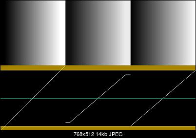

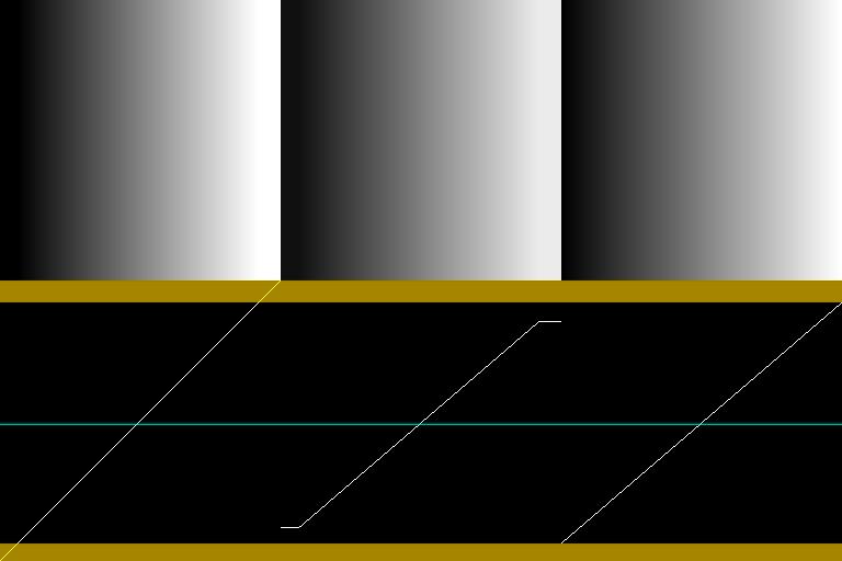

    So if I do this:
    Levels(0, 1.0, 255, 16, 235) isn't everything below 16 & above 235 clipped to 16-235, before it's converted to 16-235? It seems a bit odd to me.
  9. Originally Posted by hello_hello View Post
    So if I do this:
    Yes. You can see it here:
    On the left is a greyscale ramp from Y=0 to Y=255. In the middle is the result of Levels(0, 1.0, 255, 16, 235) (coring=true is the default). You can see that the values below 16 and above 235 were crushed before the levels change. On the right is the result of Levels(0, 1.0, 255, 16, 235, coring=false). You can see that the crushing did not occur.
