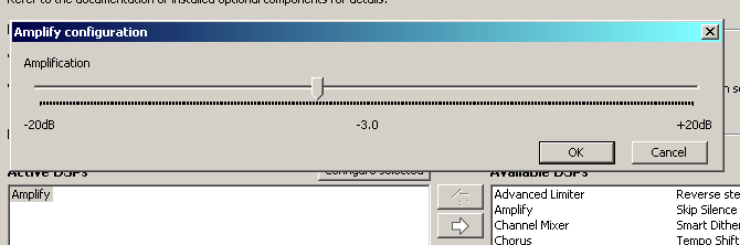

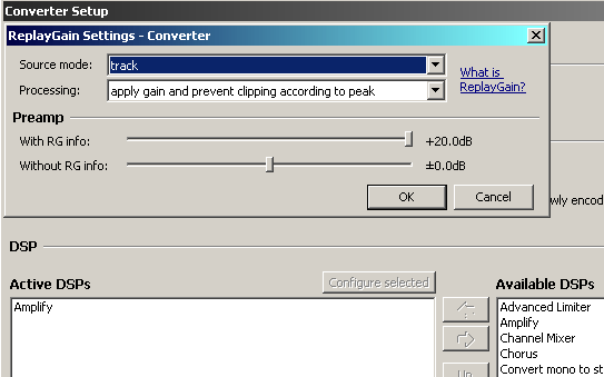

  2. Damn! Of course you can peak normalise to -3dB (or minus any dB) using foobar2000. At least when converting. Why had this not occurred to me before? I might even do it now to keep pandy happy.
    Configure the ReplayGain processing in the converter setup to peak normalise, follow it with a DSP to reduce the volume by the desired amount, and you're peak normalising to minus "x"dB. Easy peasy. The Amplify plugin is the perfect DSP for that. That's all it does. Adjust the volume up and down. Pity it's not called the volume DSP given it adjusts both ways, but you can't have everything. I've attached it as it's hard to find.
