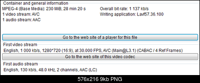

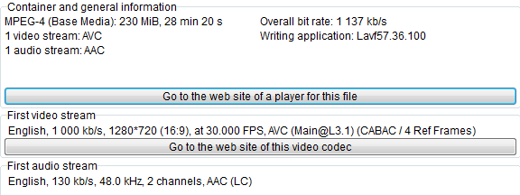

    For some reason the older batch file which did "youtube-dl -f best URL" didn't work. But the new batch file with just "youtube-dl URL" works fine.

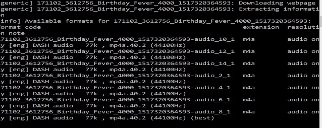

  9. Run the first command line I gave (using your url) to get a list of available streams for that URL. I get this:
    youtube-dl -F https://loudamdprod.akamaized.net/prod/dash/protected/NBCU_INTL_Production_-_Main/476/420/171102_3612756_Birthday_Fever_4000_1517320364593.mpd
    [info] Available formats for 171102_3612756_Birthday_Fever_4000_1517320364593:
    format code  extension  resolution note
    audio_10_1   m4a        audio only [eng] DASH audio   77k , m4a_dash container, mp4a.40.2 (44100Hz)
    audio_12_1   m4a        audio only [eng] DASH audio   77k , m4a_dash container, mp4a.40.2 (44100Hz)
    audio_14_1   m4a        audio only [eng] DASH audio   77k , m4a_dash container, mp4a.40.2 (44100Hz)
    audio_2_1    m4a        audio only [eng] DASH audio   77k , m4a_dash container, mp4a.40.2 (44100Hz)
    audio_4_1    m4a        audio only [eng] DASH audio   77k , m4a_dash container, mp4a.40.2 (44100Hz)
    audio_6_1    m4a        audio only [eng] DASH audio   77k , m4a_dash container, mp4a.40.2 (44100Hz)
    audio_8_1    m4a        audio only [eng] DASH audio   77k , m4a_dash container, mp4a.40.2 (44100Hz) (best)
    That only shows audio so the video must be somewhere else. Or maybe youtube-dl just doesn't see the video.
    After downloading the MDP file and opening it with Wordpad I can see that video streams are listed. So I guess youtube-dl just doesn't see them. Maybe because the site needs a login.

    I did that but sadly on m4a files
    [Attachment 44551 - Click to enlarge]

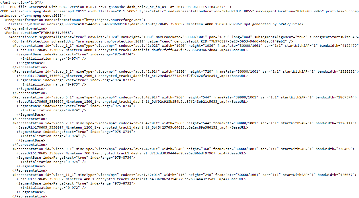

  20. Member Alex_ander's Avatar
    Oct 2006
    Russian Federation
    Originally Posted by monsterbubble View Post
    I don't know where else to find the video.
    Your .mpd describes video streams as well, e. g. the 1920x1080 version has ID: video_1_1, so you could try to specify video+audio directly using the -f option in youtube-dl:
    youtube-dl -f video_1_1+audio_2_1 https://loudamdprod.akamaized.net/prod/dash/protected/NBCU_INTL_Production_-_Main/476/420/171102_3612756_Birthday_Fever_4000_1517320364593.mpd
    I can't test it right now; it might work in case the program just fails to parse the .mpd, but it's also possible that there's some extra protection, as jagabo suspects.

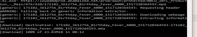

  24. So i decided to work more on this. I was only to download the audio only with the code that Alex_ander gave and i removed the video to see if it would download the audio and it did and i tested it and only used the video code to see if it downloads and it doesn't. Maybe this can help?
    [Attachment 44622 - Click to enlarge]
