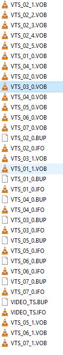

    I can copy/paste the files names that are in the folder:
    Hang on
    [Attachment 43491 - Click to enlarge]
    Aug 2013
    Central Germany
    Unfortunately it is not sorted by name, but as far as I see by skimming through, it seems to be more or less complete; being able to see the file sizes would have been helpful as well, thouh.
    VTS_??_0.VOB are menus only. Among files with the patterns VTS_XX_Y.VOB, you will most probably find the main movie in the files of that VTS XX with the longest sequence from 1 to Y; in your case, probably in VTS_02_1.VOB ... VTS_02_5.VOB; so the VTS_02_0.IFO will be the most interesting IFO file for a converter which is able to use its contained structure information.
    I hope you are able to guide Handbrake to look in VTS 02 then.

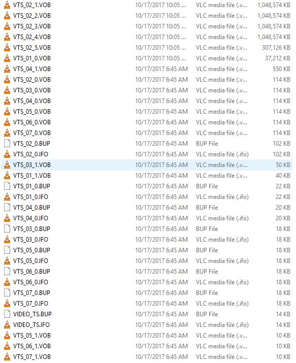

    let me resnip the files.
    Here ya go:
    [Attachment 43492 - Click to enlarge]
    Aug 2013
    Central Germany
    No need to write me private messages every time...
    Regarding sizes and amount, your rip seems to be sufficient. Now you just have to discover how to tell Handbrake to look for the main movie in Video TitleSet 02.
    Unfortunately, here I can't help you. I never use Handbrake.

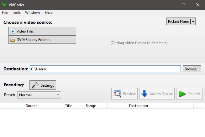

    actually, what you want to do in Handbrake, you can do in Vidcoder (which is based on Handbrake)
    [Attachment 43493 - Click to enlarge]
    But in Avidemux, you have more encoding option, automatically add Vob files too. But try Vidcoder choosing option on upper left corner. DVD, Blu-ray folder...
    Bernix
    Apr 2010
    Boston, MA
    I tried vidcoder as suggested and kept getting the generic "An error occured while scanning" Aside from their site does anyone know what else to do? I am in a quandry
