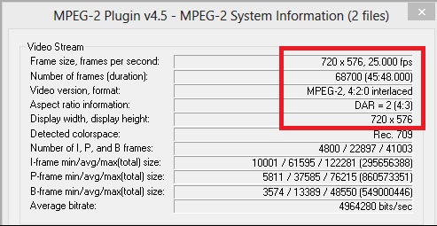

When I open Vob Files in VirtualDub, I check File Information and it says MPEG-2, 4:2:0 Interlaced.

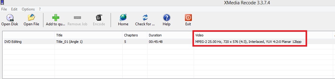

Also other programs like (DGIndex, Xmedia Recode, XviD4PSP) give Scan Type "Interlaced TFF".

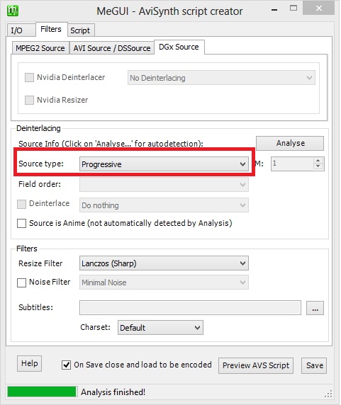

MeGui says Progressive.
The odd thing is that when I convert the video in xvid (without any filters) the converted file has scan type Progressive with (Media Info, Xmedia Recode, XviD4PSP and even MeGui).

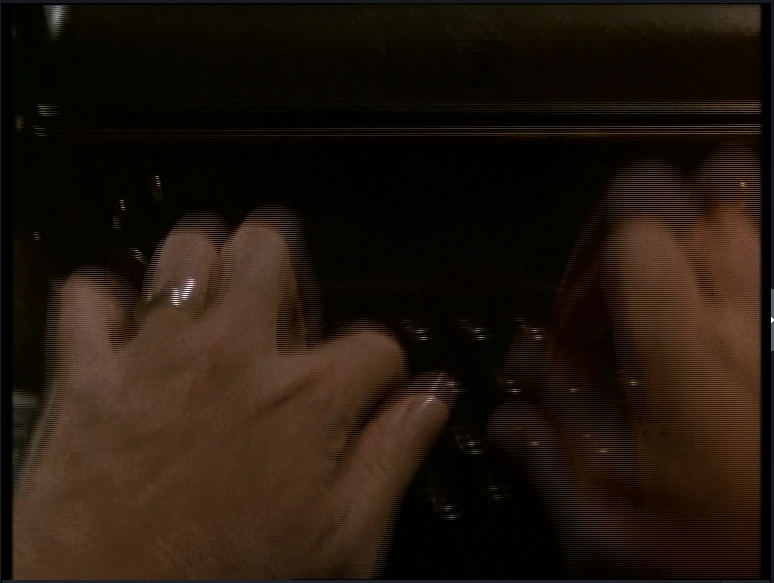

Video Lenght is 46 min and just 3 seconds seem to have interlaced lines.
I don't know if I have to use deinterlace filter or not.

Virtualdub - Original
[Attachment 43425 - Click to enlarge]
Xmedia Recode - Original
[Attachment 43426 - Click to enlarge]
MeGui - Original
[Attachment 43427 - Click to enlarge]

Interlaced Snapshoot - (only 3 seconds of video seem interlaced)
[Attachment 43433 - Click to enlarge]
