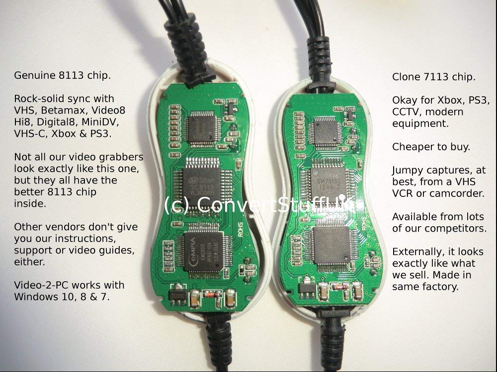

    Checked your link and the device is yet another EasyCap clone* which ranges from mediocre to outright ripoff. From the reviews, it seems this one is at best mediocre.
    *Confirmed by this pic that emphasizes they use an 8113 chip https://www.videohelp.com/search?siteurl=forum.videohelp.com&q=8113 and the case style:
    [Attachment 47584 - Click to enlarge]
    Another confirmation is that it only provides composite inputs [my emphasis]:
    Video-2-PC Kit. Suitable for use by beginners & experts. Capture video from almost any camcorder or VCR: VHS-C, Video8, Hi8, Digital8 and Mini DV camcorders via RCA phono outputs (typically yellow, red & white OR yellow & black) & VHS, Betamax or S-VHS VCR recorders via RCA phono ouputs. Can also capture from newer set-top boxes with a RCA phono outputs.
    Please stay away from this. Others will be able to provide much better alternatives for your need.
