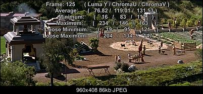

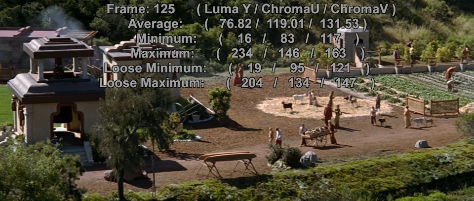

  3. AviSynth's ColorYUV(analyze=true) will show the min, max, and average luma for each frame. It also shows the "loose min/max" values which excludes a small fraction of the lowest and highest values (typically noise). It also reports all those values for the U and V channels.
    But you'll have to install AviSynth, a third party source filter (LSmash or DGMpegDec), and learn some basic scripting -- it's a plain text based scripting language. A simple script may look like:
    LWlibavVideoSource("filename.mpg") # open the video
    ColoryUV(analyze=true) # show statistics
    Then you open the script as if it was a video file with a media player or editor that supports AviSynth scripts. VirtualDub works well for that.

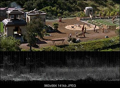

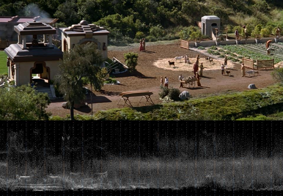

    I don't know exactly what your purpose is but a waveform monitor is generally more useful once you know what it means:
    See: https://forum.videohelp.com/threads/340804-colorspace-conversation-elaboration#post2121568
    Most video editors have such a display. Sony Vegas, for example.
