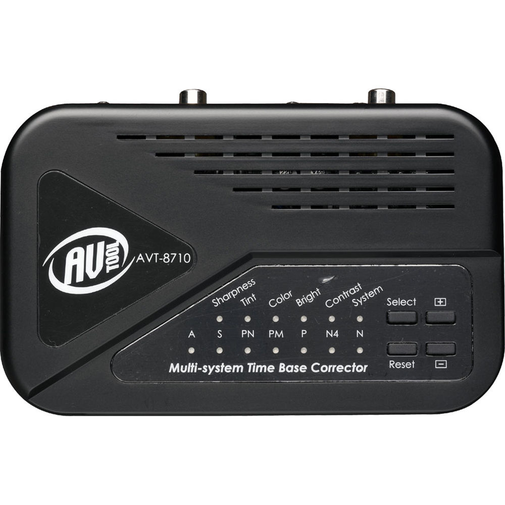

  1. i have a Av Toolbox AVt-8710 for free for you cover postage and its yours - - make a post and i will choose at random
    ive been help'd so much from the experts on here and this is just a chance for me to help someone else
    [Attachment 43401 - Click to enlarge]

    The black model has ghosting problems and repeated frame problems.
    Free is a good price for something with such flaws.
    Nice offer.

    "TBC" is a term with wide latitude for what counts as one, with many failing to handle the basic tasks that are expected from TBCs. So you have to be really careful. The CTB-100/AVT-8710 is a pure TBC. That one tends to be more obvious. But the KDVP8 is for other uses, but TBC built-in. That's often where you find poor uses of the terminology, such as DVD recorder, cameras or DV boxes with "TBCs" that do nothing discernible. Since he doesn't even notice the drawbacks of the modern Cypress chipsets, I'd wager he has zero input in such a pricey device. Simply put, be wise, don't trust the marketing and tech specs. Verify with third-party references -- and qualified ones (ie somebody that truly knows video, not a "reviewer").
    Originally Posted by hdfills View Post
    well it worked perfect for me before i got my video processor so i have no idea what your talking about
    You may not notice, but the problem is still there. An easy test is to use a JVC S-VHS VCR, and watch what happens when you navigate the menus. It happens all through a tape conversion, at random times. The JVC test is simply a known-reproduceable test. A flawless unit, earlier models, had no such problems.

    After 2 days you came to that conclusion? Again, I think it's a kind offer for somebody who may want to use/test a known-flawed device.

    I have the exact same box and when hooking it up in the stream I too haven't noticed any improvement, Couldn't see any degradation to the signal though, Maybe I should try the JVC menu trick that Lordsmurf mentioned above when I get time.
    I posted a thread here and Lordsmurf was the only one to answer it:
    http://www.digitalfaq.com/forum/video-capture/7311-genuine-avt-8710-a.html

    I honestly thought that this particular piece of kit had zero use for time-base corrections for standard VHS captures ie tearing. Whereas it should help for jumpy pictures and macrovision.
    On that basis I felt I had no use for this - offer was made elsewhere as well.
    External TBCs are for cleaning the signal, not the image. Signal timing errors causes all sorts of capture-time errors, from dropped frames to capture cards refusing to lock onto the analog tape signal. Line/field TBCs inside S-VHS VCRs, and a few rare DVD recorders (ES10/15 on passthrough), are what clean an image. The DNR is merged with those TBCs, noting that on-deck DNR has more settings to make it stronger yet.
    It's not obvious until you watch an entire capture. You'll see lots of frame oddities from the bad black AVT-8710: reversed frames, frame repeats, ghosting, digital tearing (not analog tearing).
