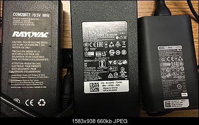

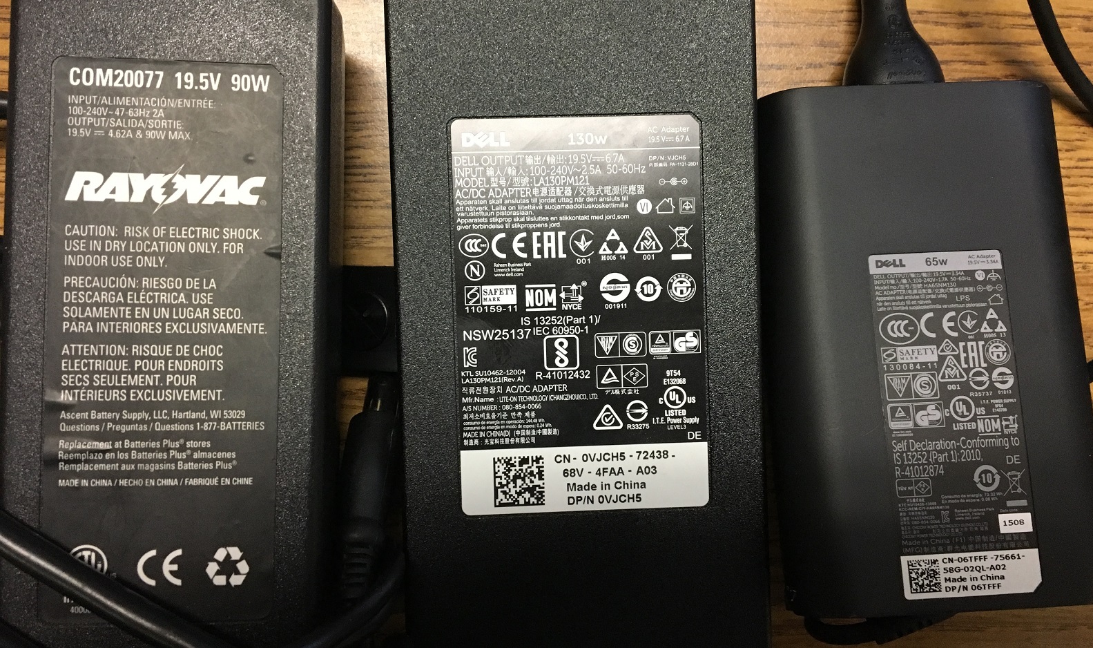

  4. You just need the to worry about output. Here is an example of 3 different ac adapters that will work with Dell Latitudes
    They all output 19.5V but have different amps V*A = W
    In Dell's case, higher the wattage, the faster it will charge in most cases. Dell has a built-in charging circuit regulator

    Originally Posted by jagabo
