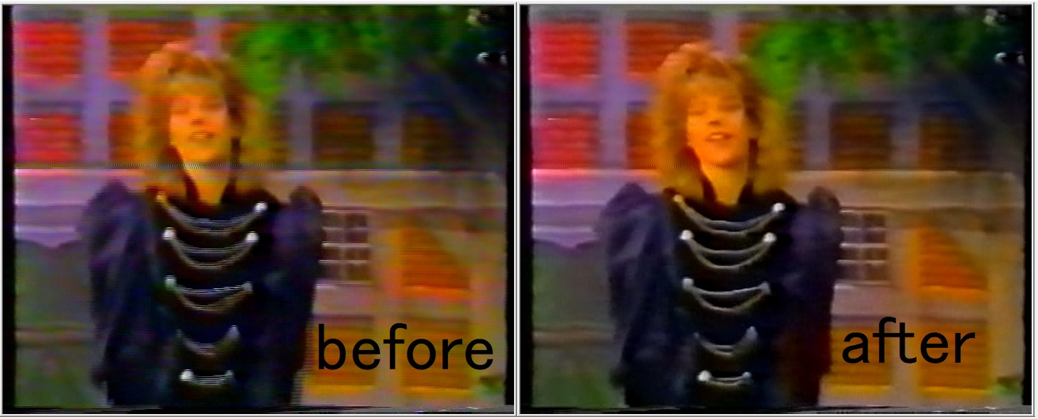

    Just as an FYI, this thread did have a happy ending. First 1000 frames tested quite nicely. Time to now run on full video.
    See attached!
    What was required:
    - my prep script (60fps)
    - KNLmeansCL script from poison, but with values altered/lowered (10fps)
    - my denoise script (10fps)
    - my deint/stab script (10fps)
    - VirtualDub work
    Avisynth+ x64 now installed with Avisynth 2.6 MT. Good combo.
    BTW: The x64 KNL script still used Intel GPU, though without any OpenCL.

    What was required:
    - VirtualDub work
    Could you please describe further what you did other than the script from posion?
    I have a similar problem with a file. The script already fixed some of the color distortions but not all.
    [Attachment 56973 - Click to enlarge]
    What filters would I need for correcting the oversaturated and sometimes wrong colours?
    A excerpt of the uncorrected video is attached.
