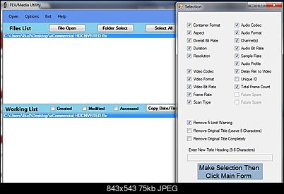

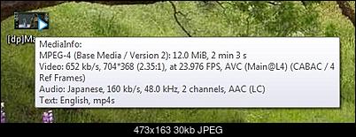

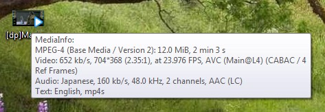

    As mentioned previously MediainforCLI will give a screen or text result and if you have MediaInfo installed, the mouseover can be activated in the options to show also. Notice it gives aspect as 2.35:1 but the dimensions tells it is anamorphic (1.91:1, 704x368)

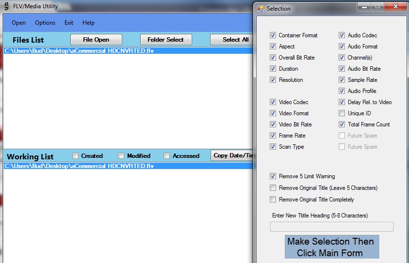

    OR CLI:
    Template.txt:
    General;Container Format = %Format%_\r\nOverAllBitRate = %OverallBitRate/String%_\r\nDuration = %Duration/String%_\r\n
    Video;Aspect = %DisplayAspectRatio/String%_\r\nResolution = %Width%x%Height%_\r\nVideo Codec = %CodecID%_\r\nVideo Format = %Format%_\r\nVideo Bit Rate = %BitRate/String%_\r\nFrame Rate = %FrameRate%_\r\nScan Type = %ScanType%_\r\nTotal Frames = %FrameCount%_\r\n
    Audio;Audio Codec = %CodecID%_\r\nAudio Format = %Format%_\r\nChannels = %Channel(s)%_\r\nAudio Bit Rate = %BitRate/String%_\r\nSample Rate = %SamplingRate/String%_\r\nAudio Profile = %Format_Profile%_\r\nAudio Delay = %Video_Delay/String1%_\r\n
    Output:
    C:\Users\Bud\Desktop\Mega_FLV Only stripped\bin\Debug>"C:\Users\Bud\Desktop\Mega_FLV Only stripped\bin\Debug\MediaInfo.exe" --Output=file://"C:\Users\Bud\Desktop\Mega_FLV Only stripped\bin\Debug\Template.txt" "C:\Users\Bud\Desktop\aCommercial HDCNVRTED.flv"
    Container Format = Flash Video_
    OverAllBitRate = 1 513 Kbps_
    Duration = 14s 999ms_
    Aspect = 16:9_
    Resolution = 720x480_
    Video Codec = 7_
    Video Format = AVC_
    Video Bit Rate = 1 348 Kbps_
    Frame Rate = 23.976_
    Scan Type = Progressive_
    Total Frames = 358_
    Audio Codec = 2_
    Audio Format = MPEG Audio_
    Channels = 2_
    Audio Bit Rate = 96.0 Kbps_
    Sample Rate = 44.1 KHz_
    Audio Profile = Layer 3_
    Audio Delay = 83ms_
