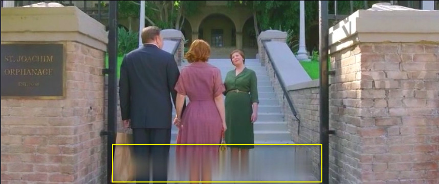

  1. would anyone know what program can blur subtitles, as like in snapshot below

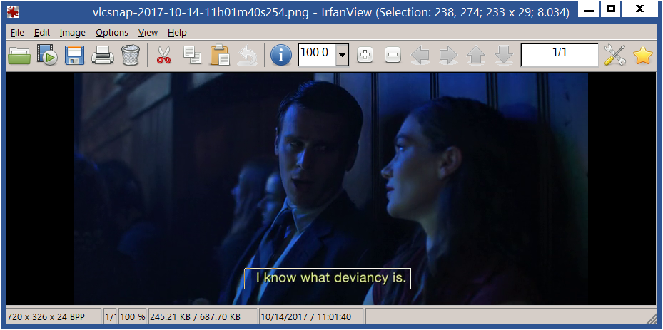

  7. would anyone know how my 1st post was done, what program, as I have tried AviUtil Imas Uncaption but cant get same results.
    Also tried msu_subtitle_remover but dont understand about 1st pass etc and 2nd pass, do that mean you must play video all way through, then again on 2nd pass as thats a long process
  8. I don't know how the one in your post was done but Pandy already pointed to using delogo filter with ffmpeg. This code in a CMD window
    ffmpeg -i "Before.mkv"  -vf delogo=x=250:y=650:w=800:h=50 -c:a aac -b:a 192k "After.mkv"
    gives the attached before/after so you can see if you find that satisfactory.

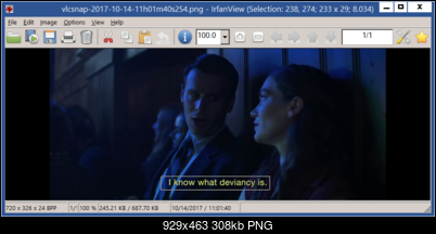

  20. Your problem is that the coordinates used (x=250:y=650:w=800:h=50) doesn't fit your video. Those coordinate was for a 1280x720 frame. Yours is 720x304.
    You can use Irfan View to get the coordinate. First make a screen dump from the video. In VLC you could use Video -> Take Snapshot. Open the snapshot in IrFan View and hold down your mouse button and draw a rectangle around your subtitle. In the window caption at the top it'll say something like Selection 238,274 ;233x29. These are your X, Y, W, h
    so you use
    "c:\Program Files\ffmpeg-3.3.3-win64-static\bin\ffmpeg" -i %1  -vf delogo=x=238:y=274:w=233:h=29 -c:a aac -b:a 192k "%~dpn1.delogo.mkv"

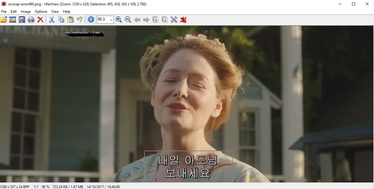

    Hi many thanks for helping me its most appreciated but it still dont work
    D:\downloads_D\Annabelle Creation 2017 720p HDRip-x264-AC3 5.1-Jarvis>"c:\Program Files\ffmpeg-3.3.3-win64-static\bin\ffmpeg" -i "D:\downloads_D\Annabelle Creation 2017 720p HDRip-x264-AC3 5.1-Jarvis\Annabelle Creation 2017 720p HDRip-x264-AC3 5.1-Jarvis.mkv" -vf delogo=x=495:y=428:w=303:h=109,2.780 -c:a aac -b:a 192k "D:\downloads_D\Annabelle Creation 2017 720p HDRip-x264-AC3 5.1-Jarvis\Annabelle Creation 2017 720p HDRip-x264-AC3 5.1-Jarvis.delogo.mkv"
    ffmpeg version 3.3.3 Copyright (c) 2000-2017 the FFmpeg developers
    built with gcc 7.1.0 (GCC)
    configuration: --enable-gpl --enable-version3 --enable-cuda --enable-cuvid --enable-d3d11va --enable-dxva2 --enable-libmfx --enable-nvenc --enable-avisynth --enable-bzlib --enable-fontconfig --enable-frei0r --enable-gnutls --enable-iconv --enable-libass --enable-libbluray --enable-libbs2b --enable-libcaca --enable-libfreetype --enable-libgme --enable-libgsm --enable-libilbc --enable-libmodplug --enable-libmp3lame --enable-libopencore-amrnb --enable-libopencore-amrwb --enable-libopenh264 --enable-libopenjpeg --enable-libopus --enable-librtmp --enable-libsnappy --enable-libsoxr --enable-libspeex --enable-libtheora --enable-libtwolame --enable-libvidstab --enable-libvo-amrwbenc --enable-libvorbis --enable-libvpx --enable-libwavpack --enable-libwebp --enable-libx264 --enable-libx265 --enable-libxavs --enable-libxvid --enable-libzimg --enable-lzma --enable-zlib
    libavutil 55. 58.100 / 55. 58.100
    libavcodec 57. 89.100 / 57. 89.100
    libavformat 57. 71.100 / 57. 71.100
    libavdevice 57. 6.100 / 57. 6.100
    libavfilter 6. 82.100 / 6. 82.100
    libswscale 4. 6.100 / 4. 6.100
    libswresample 2. 7.100 / 2. 7.100
    libpostproc 54. 5.100 / 54. 5.100
    Input #0, matroska,webm, from 'D:\downloads_D\Annabelle Creation 2017 720p HDRip-x264-AC3 5.1-Jarvis\Annabelle Creation 2017 720p HDRip-x264-AC3 5.1-Jarvis.mkv':
    Metadata:
    title : Annabelle Creation 2017 720p HC HDRip-x264-AC3 5.1-Zi$t-WWRG
    encoder : libebml v1.3.4 + libmatroska v1.4.5
    creation_time : 2017-09-14T12:17:08.000000Z
    Duration: 01:49:28.10, start: 0.000000, bitrate: 802 kb/s
    Stream #0:0: Video: h264 (Main), yuv420p(tv, bt709, progressive), 1280x536 [SAR 402:403 DAR 960:403], SAR 254:255 DAR 8128:3417, 23.98 fps, 23.98 tbr, 1k tbn, 180k tbc (default)
    Metadata:
    BPS : 417026
    BPS-eng : 417026
    DURATION : 01:49:28.102000000
    DURATION-eng : 01:49:28.102000000
    NUMBER_OF_FRAMES: 157469
    NUMBER_OF_FRAMES-eng: 157469
    NUMBER_OF_BYTES : 342384348
    NUMBER_OF_BYTES-eng: 342384348
    _STATISTICS_WRITING_APP: mkvmerge v13.0.0 ('The Juggler') 64bit
    _STATISTICS_WRITING_APP-eng: mkvmerge v13.0.0 ('The Juggler') 64bit
    _STATISTICS_WRITING_DATE_UTC: 2017-09-14 12:17:08
    _STATISTICS_WRITING_DATE_UTC-eng: 2017-09-14 12:17:08
    _STATISTICS_TAGS: BPS DURATION NUMBER_OF_FRAMES NUMBER_OF_BYTES
    _STATISTICS_TAGS-eng: BPS DURATION NUMBER_OF_FRAMES NUMBER_OF_BYTES
    Stream #0:1(eng): Audio: ac3, 48000 Hz, 5.1(side), fltp, 384 kb/s (default)
    Metadata:
    BPS : 384000
    BPS-eng : 384000
    DURATION : 01:49:28.032000000
    DURATION-eng : 01:49:28.032000000
    NUMBER_OF_FRAMES: 205251
    NUMBER_OF_FRAMES-eng: 205251
    NUMBER_OF_BYTES : 315265536
    NUMBER_OF_BYTES-eng: 315265536
    Stream mapping:
    Stream #0:0 -> #0:0 (h264 (native) -> h264 (libx264))
    Stream #0:1 -> #0:1 (ac3 (native) -> aac (native))
    Press [q] to stop, [?] for help
    [Parsed_delogo_0 @ 00000000025602a0] Note: default band value was changed from 4 to 1.
    [AVFilterGraph @ 000000000289a3c0] No such filter: '2.780'
    Error reinitializing filters!
    Failed to inject frame into filter network: Invalid argument
    Error while processing the decoded data for stream #0:0
    [aac @ 000000000255d260] Qavg: 127.027
    [aac @ 000000000255d260] 2 frames left in the queue on closing
    Conversion failed!
    D:\downloads_D\Annabelle Creation 2017 720p HDRip-x264-AC3 5.1-Jarvis>pause
    Press any key to continue . . .
    here is the .bat file
    "c:\Program Files\ffmpeg-3.3.3-win64-static\bin\ffmpeg" -i %1 -vf delogo=x=495:y=428:w=303:h=109,2.780 -c:a aac -b:a 192k "%~dpn1.delogo.mkv"
    pause
    here is below the snap i took of subtitle on movie in vlc, and placed it in Irfanview
  22. Delete this ,2.780
    "c:\Program Files\ffmpeg-3.3.3-win64-static\bin\ffmpeg" -i %1 -vf delogo=x=495:y=428:w=303:h=109 -c:a aac -b:a 192k "%~dpn1.delogo.mkv"
    pause

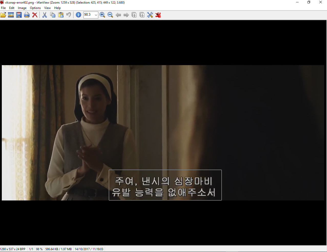

    Hi I just tried that before i read your reply and now its doing something, so it must be working, does ffmpeg have delogo filter already in it, as I cant see where, filters are
    dam i give up here as it was working I tried a short part of video it was great blurred subtitles great so now I try again and its not working again
    D:\downloads_D\Annabelle Creation 2017 720p HDRip-x264-AC3 5.1-Jarvis>"c:\Program Files\ffmpeg-3.3.3-win64-static\bin\ffmpeg" -i "D:\downloads_D\Annabelle Creation 2017 720p HDRip-x264-AC3 5.1-Jarvis\Annabelle Creation 2017 720p HDRip-x264-AC3 5.1-Jarvis.mkv" -vf delogo=x=425:y=415:w=449:h=122 -c:a aac -b:a 192k "D:\downloads_D\Annabelle Creation 2017 720p HDRip-x264-AC3 5.1-Jarvis\Annabelle Creation 2017 720p HDRip-x264-AC3 5.1-Jarvis.delogo.mkv"
    Metadata:
    Metadata:
    BPS : 417026
    BPS-eng : 417026
    Metadata:
    BPS : 384000
    BPS-eng : 384000
    Stream mapping:
    [Parsed_delogo_0 @ 00000000027e0860] Note: default band value was changed from 4 to 1.
    [delogo @ 000000000256fac0] Logo area is outside of the frame.
    [Parsed_delogo_0 @ 00000000027e0860] Failed to configure input pad on Parsed_delogo_0
    [aac @ 00000000027ad540] Qavg: 127.027
    [aac @ 00000000027ad540] 2 frames left in the queue on closing
    Conversion failed!
    here is bat file
    "c:\Program Files\ffmpeg-3.3.3-win64-static\bin\ffmpeg" -i %1 -vf delogo=x=425:y=415:w=449:h=122 -c:a aac -b:a 192k "%~dpn1.delogo.mkv"
    pause
    here is snapshot
  24. You have a video with a frame size of 1280x536.
    You're using the coordinates of x=425:y=415:w=449:h=122. This brings your y-coordinate to 415+122=537, ie outside the frame with the error Logo area is outside of the frame.
    Try with
    "c:\Program Files\ffmpeg-3.3.3-win64-static\bin\ffmpeg" -i "%1" -vf delogo=x=425:y=415:w=449:h=120 -c:a aac -b:a 192k "%~dpn1.delogo.mkv"
    pause
  25. Originally Posted by videobruger View Post
    Try with
    pause
