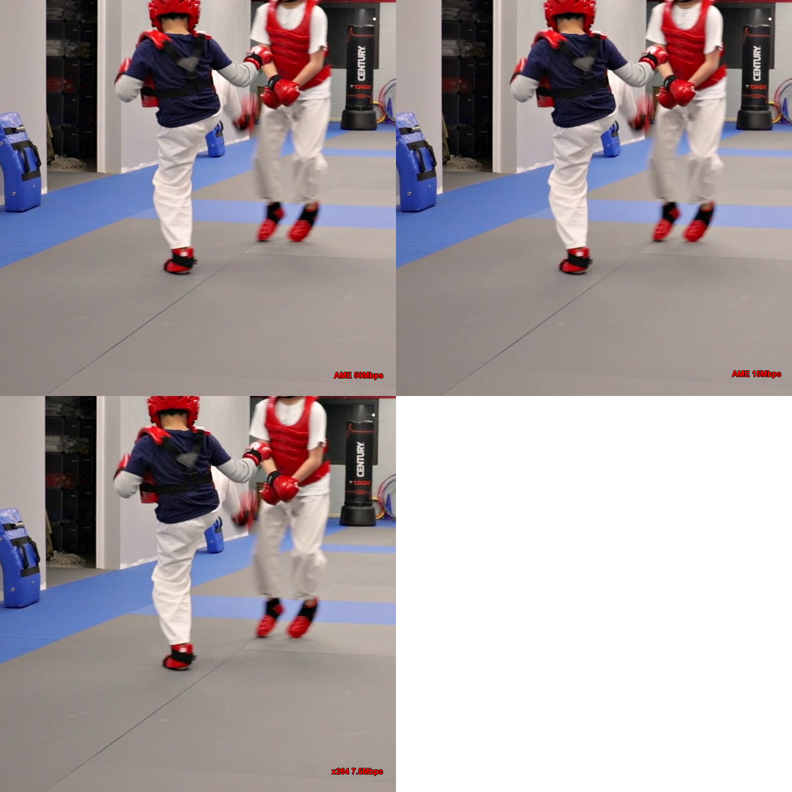

  28. For years, I've being using FFmpeg (x264) to encode videos. I'm amazed of its bitrate/quality.
    I've never been satisfied with PR or AME's H.264 encoding quality. For example, a Canon 6D2 30Mbps HD/24p clip, after sharpen in PR, I usually need AME 50Mbps (the max settings) to resolve details, the "Match Source High Quality" preset 15Mbps is not enough, it lost details.
    With this plugin, encoded with slow preset CRF 20, I got 7.5Mbps video, and the quality matches AME 50Mbps. See the attached screenshot for 100% crop. Note:
    On still part, AME 50Mbps and x264 7.5Mbps has texture details on floor, AME 15Mbps does not.
    On action part, see the red vest of the boy, AME 15Mbps has JPG artifact, the other two don't.
    Vouk did a great job to bring back real power of H.264.
    Thank you!

  29. #Voukoder developer
    Oct 2017
    Germany
    Thanks, guys.
    Oh, and yes: Voukoder has similar quality compared to FFmpeg because it is using FFmpeg / libav inside.

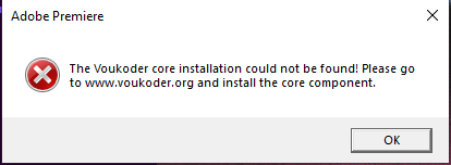

  30. How do you install the core in Premiere Pro?
