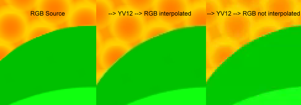

I want to convert yv12 to rgb interpolated, apparantly magicyuv is pretty fast for this.
I want magicyuv to use the for the commands :converttoyv12 and the converttoRGB32. as example. Since I think avisynth is currently using LAV of MPC-HC. https://forum.videohelp.com/images/guides/p1784363/yv12.png
