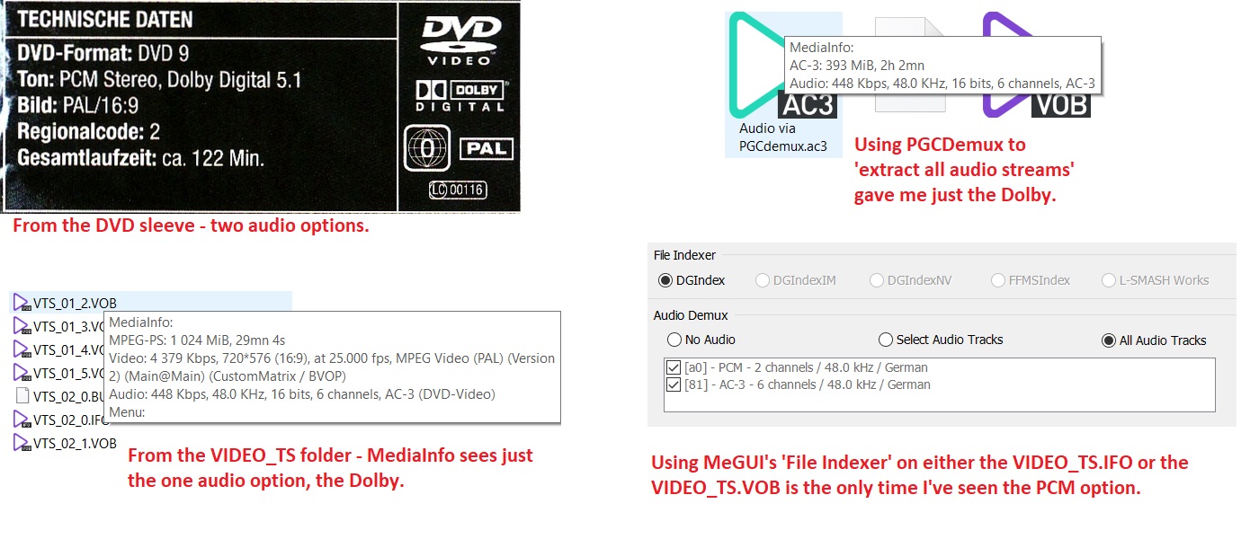

  1. Hi. I have a DVD of a concert that I want to encode for use on my lounge telly. The media player is HDMI'd to the TV and RCA'd to my old-fashioned amplifier. I don't want to encode the audio, I'd prefer to keep the original. Being an old stereo amp, I'm better off with the PCM audio, yes?
    My problem is best seen in the attachment. How do I extract the PCM so that I can get MeGUI to convert the video and use the PCM audio?

  2. Can't you get it when making the D2V using DGIndex? If you don't get it, then there is none.
    Assuming you get the PCM WAV file, if there isn't a way to pass through audio in MeGUI (don't know as I don't use it) then encode just the video and mux in the PCM afterwards.
  3. Thanks, manono. Well, I analysed the VOBs with DGIndex and also used AudioMuxer. Both indicate that the audio is AC-3 only. Which leaves me confused - why does the DVD begin with a menu for sound selection if there's just one track? And why is the final shot in the atachment above showing PCM and AC-3?

  5. Originally Posted by pooksahib View Post
    ...why does the DVD begin with a menu for sound selection if there's just one track? And why is the final shot in the atachment above showing PCM and AC-3?
    The menu, because the DVD makers are idiots. The picture, because the DVD makers 'turned on' a PCM audio track, but just forgot to include it.
