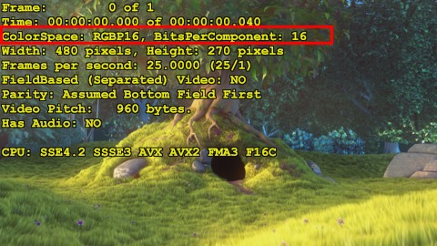

Using AvisynthPlus & FFmpegSource
Code:FFImageSource("BBB_01_04_dpx_linear.dpx") ## next 2 lines only for this test image BicubicResize(Width/4, Height/4) Info ## next line only for display on vdub ConvertBits(8, dither=0).ConvertToRGB32
[Attachment 43316 - Click to enlarge]Last edited by raffriff42; 8th Oct 2017 at 13:28.
@rr42 - he needs an image "sequence" . Do you have a workaround in avisynth+ besides splicing ? In vpy you can use ffms2 + python to load a sequence, but not in avisynth
Okay sorry, not reading the whole thread, again. Your suggestion sounds like it will work.
