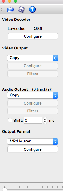

    Thanks for the reply. Would these be the correct settings for avidemux?
    [Attachment 43284 - Click to enlarge]
  4. Member Bernix's Avatar
    Apr 2016
    Europe
    yes, or you can try if this will not work mp4v2 as output.
    Iam not sure about 3 audio track in mp4 but it should be o.k.

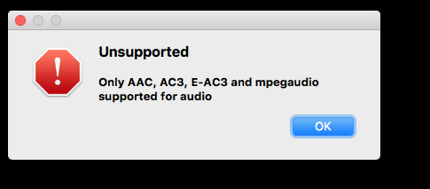

    No. Got this error.
    [Attachment 43285 - Click to enlarge]
  7. Member Bernix's Avatar
    Apr 2016
    Europe
    So in avidemux, you can in audio change the audio track convert to aac. It is relatively fast. Select AAC (FDK) and choose desired bitrate.
    From menu on top, select audio tracks and convert them to aac. In configuration. And filter there you can choose stereo 5.1 etc.
    Try post Mediainfo of mkv file. Name of the file is not needed, just part about audio.
    Bernix

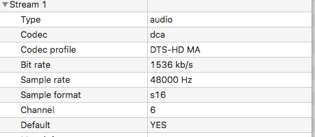

    I see what you said about the settings but that's going to compress my DTS-HD audio down to 640 bitrate which is not the same correct? Here is the file audio info:
    [Attachment 43286 - Click to enlarge]
  9. Member Bernix's Avatar
    Apr 2016
    Europe
    Hm, that is bit a problem... But you would to convert it if you want to play it on your devices. Just try 5.1 aac fdk. Just try it on max bitrate. It is not losseless but it depends on your ears, you have to try it....

    MP4 can contain DTS, that warning is from avidemux ?
  11. Originally Posted by Bernix View Post
    Yes.

    Have you try MP4v2 ? But I doubt it will be supported by apple TV and XBOX one. I see only way to convert to aac 5.1
    Bernix

  14. You will have to convert audio, anyway. Xbox One media center does not support DTS-MA in MKV containers. AAC max bitrate is best you can have at this time.
    Unless things have changed recently...
