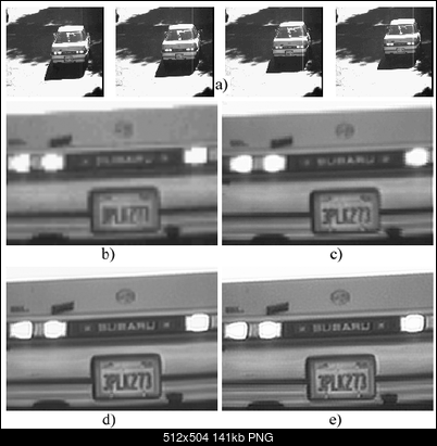

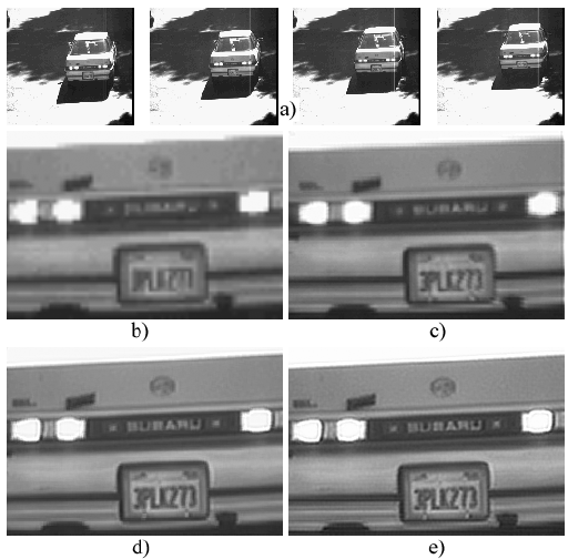

    I also remembered an old scientific paper I read a decade ago. At the time, it was extremely new tech, but I wondered if anything like it is available now. In the paper, they used stacking like astronomers do, but with a more sophisticated algorithm along the way. Here's the paper I read:
    https://www.researchgate.net/figure/1957977_fig4_Fig-4-Superresolution-results-on-the-...equence-frames
Name:	Fig-4-Superresolution-results-on-the-car-sequence-a-Several-input-sequence-frames.png
    There are even more advanced approaches now, but they seem maybe too new to have made it into affordable software:
    https://www.researchgate.net/publication/51990255_A_PCA-Based_Super-Resolution_Algorit...mage_Sequences
    As you can see, it is used to make a previously non-legible license plate completely legible. While this is used on multiple frames to produce a single image, it made me think of how many videos there are out there of things like cartoon intros, from many sources. While there may not be any two identical frames in any one video of high action animation, we do have that frame duplicated across many videos from many different VHS tape recordings. So the algorithm would have to stack these videos on each other, aligning the frames, and dig down through the different clips.
