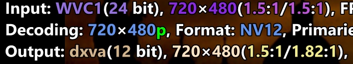

    Scan type : Progressive
    Scan order : Bottom Field First
    This is what potplayer said.
    [Attachment 43247 - Click to enlarge]
    Dec 2009
    I don't know where IMDB got that - it's clearly squashed at 4:3. It's definitely meant to be some kind of widescreen. Perhaps there was some 4:3 VHS release of it at some point and IMDB got the ratio from there?
    And yeah... that Progressive + Bottom Field First readout is really weird too, isn't it? I'm guessing the original DVD version was deinterlaced for the BD release, but that somehow that BFF tag was left intact. The video is clearly Progressive when viewed frame by frame in VirtualDub. But SD special features from BD's are often very strange. I'm guessing it's just not cost-effective to properly retransfer/remaster old DVD material, so they just take the old file or a digital intermediary, do a quick and dirty reencode, and throw it on there figuring that few people will ever notice. And that's probably reasonable.
