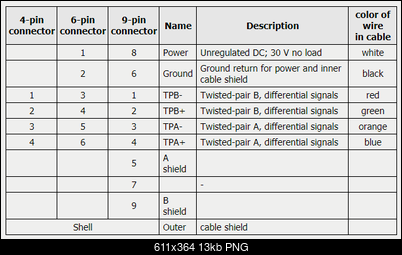

  17. aBigMeanie aedipuss's Avatar
    Oct 2005
    666th portal
    here's the wiring diagram for firewire. camcorders only use 4 pin connectors. so were's the power going to come from to "fry" a port??? even the shells are grounded end to end so no static charge.
