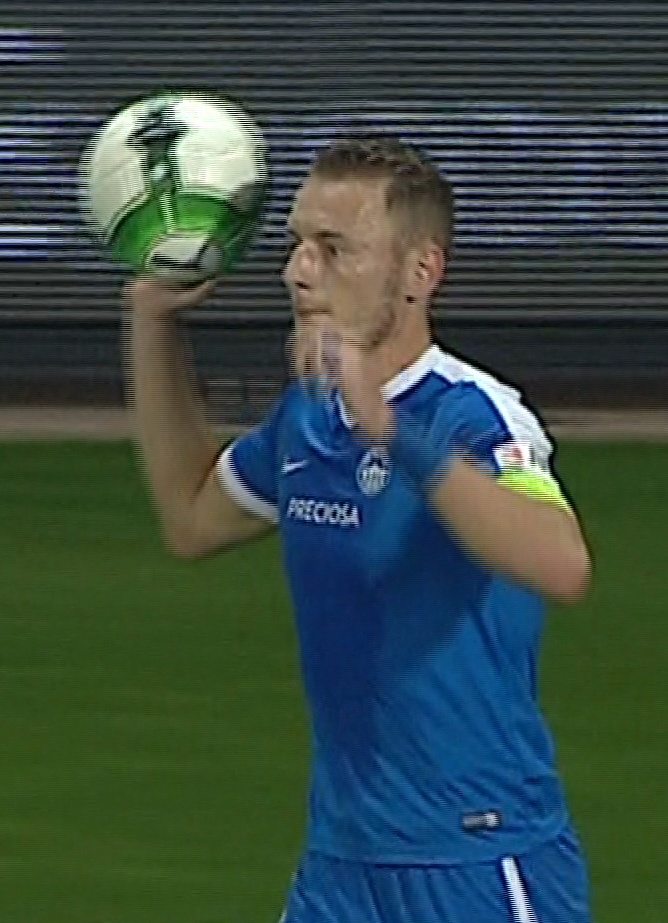

I am not sure, but in our country TV in dvb-t broadcast something interlaced and something not. When is it interlaced, and you try to edit it, you can see stripes between top and bottom fields. But if is it possible I use direct stream copy even it is interlaced. Therefore there is bob I think. if is it progresive and you used bob, so the next frame is identical (almost) to previous, but when is it interlaced, then each frame is unique - 50p 20ms frame duration.

Here is what I see and it is hd live coverage....
[Attachment 43244 - Click to enlarge]
It is croped from 1920x1080
