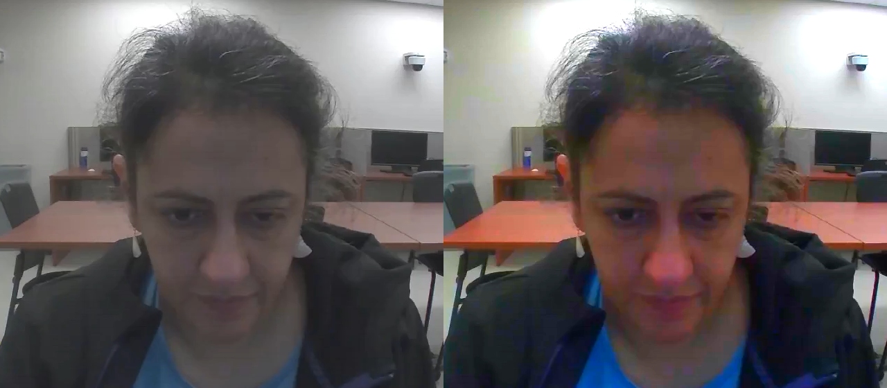

    The quality of the video . eg. Is it "clear" or not? Is it "clean" and look high quality to you? Are their compression artifacts / macroblocking, especially in the shadows, those sorts of things - because not only do those interfere with the tracking accuracy of your (and other) programs, it also means there will be less data in the neckline region to enhance
    Youtube re-encodes everything, so quality is lower, but it looks to be poor quality to begin with
    But on a video like that I would increase the contrast and saturation, and that should increase the separation of the neckline, it might be enough for your program to discriminate the neckline

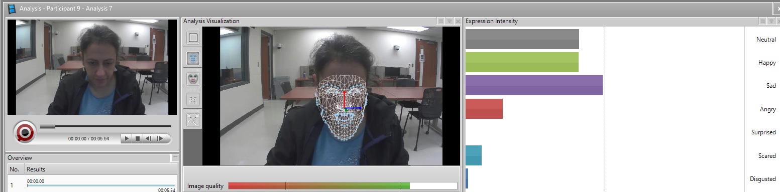

    The software I'm using is called FaceReader. It maps 500 points on to facial landmarks (like eyebrows) and uses something called the "Active Appearance Model" - it's their version of the implementation, but the original says that AAM "contains a statistical model of the shape and grey-level appearance of the object of interest" (Cootes et al. 1998). An "appearance vector" models this information and is then fed through a neural net whose output is the intensity of each of 6/7 basic emotions. Interesting in theory anyways.
    Attached is an image of an example of when it mis-reads the face (due to lighting issues, I'm guessing). It makes this mistake frequently through about half of our 100+ videos. The manual states that changing settings such as contrast after-the-fact won't have any effect, but it's worth a try since this data was collected with some effort...
