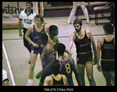

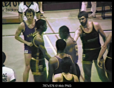

    I have a 720x576 50fps progressive AVI.
    I have two AviSynth scripts:
    AVISource("File.avi")
    AssumeTFF().SeparateFields().SelectEvery(4,0,3).Weave()
    ConvertToYV12(matrix="rec601",interlaced=true)
    SelectEven()
    Spline36Resize(768,576)
    ConvertToYV12(matrix="rec601",interlaced=false)
    The progressive square-pixel version is encoded in MeGUI with Force SAR set to 1:1. The interlaced version has Force SAR set to 12:11, which I'm led to believe is correct for PAL 4:3, and should make the two the same when I play them in VLC.
    Except...it doesn't:
    Where have I gone wrong?
  2. 720 * 12/11 is 786, not 768. (Have not tested. Try it.)
  3. Member koberulz's Avatar
    Oct 2006
    Australia
    So should I be adjusting the progressive version to a width of 786, or the interlaced version to a SAR of 16:15?
  4. In theory, 704x576 = 4:3 so you'd resize to 786x576 square pixels, or crop 8 pixels from each side and resize to 768x576 square pixels, or you'd set 16;15 as the SAR (whether you crop 8 pixels or not).
    I say "in theory" because I don't know what the source is, and whether it was created using the above method or of it was created assuming 720x576 = 4:3 (in which case you'd use 12:11 for the SAR).
