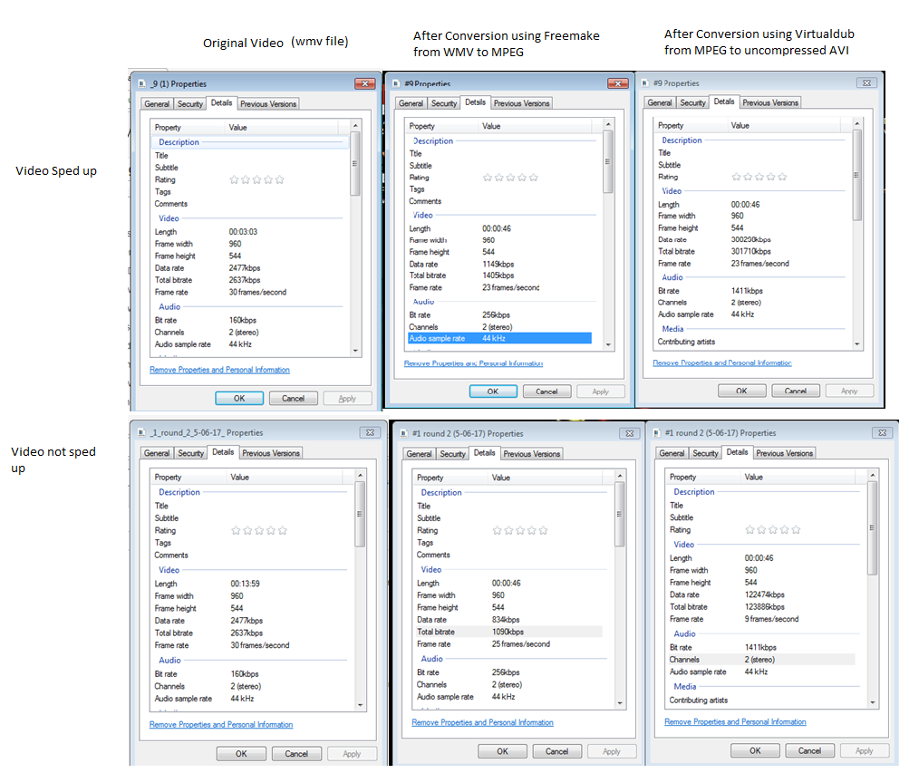

    I have encountered a small issue with video speeds when using Virtualdub to convert files from .mpg to AVI and was wondering if anyone can help.
    Does anyone possibly know why the duration of an event in a converted video might be faster than when compared to the original file? And what role the frame rate might have (even if the audio and video have the same duration)?
    The process involved: an .mpg file being converted to uncompressed AVI form, with the "Video" > "Frame rate" > "Source rate adjustment"> "Change so video and audio durations match" selection checked.
    I have attached “properties” page of the videos in the image below (Columns 2 and 3). Sometimes the converted videos did not change speed (row 2) but most did (row 1) and the only difference I noticed was that the converted AVI file had fewer frames per second. To amend for this, I had changed the frame rate selection to “no change”. The video converted from this maintained the frame rate but was then sped up to 18 s, compared to the 46 s of the original video.
    I have included an extra column (first column) which shows the properties of the original video in case that is of any use - that had a much longer duration than the .mpg file as only a certain segment of interest was used. The original video was converted from .wmv to .mpg using Freemake.
    [Attachment 43222 - Click to enlarge]
    Sorry for my ignorance. Any help will be greatly appreciated. Thanks!

    Yes the overall running times are the same (strangely). The problem is that the duration of an event in the MPG file is different to in the AVI file - and timing is important as it is a variable that I am measuring.
    Though, now that you mention time codes, I'm guessing that perhaps the MPG file also had a variable frame rate which was removed by Virtualdub during the conversion to AVI. And that may have caused the time difference. I shall check the next time I have access to the videos again (which will be next Tuesday), so I'll update everyone then. If it is the case with the variable frame rate, are there any good alternatives to Virtualdub that works with variable frame rates (preferably free)?

    Hi Jagabo and sorry for the delay. These are the information obtained from MediaInfo and I have put them below. Do you or possibly anyone have any insight after looking at them?
    Number 1 is the video that when converted, did not change the length of the event of interest whilst Number 9 is the video that was converted oddly. I have included the information from the original .wmv, the .mpg (converted by freemake) and the final uncompressed .avi file.
    The MPEG files do not have a "Frame rate mode" entry so I am guessing it does have a constant frame rate and isn't a cause of the problem.
    One other guess is, would having a video watermark affect the video speeds in any way? When Freemake was used to convert the wmv file to MPEG, it added 3 s watermarks before and after the video. Before (I think last year), when it didn't add watermarks, the videos converted did not have the problem that I am having.

    Thank you and anyone else who is trying to help.
  12. Originally Posted by hwvd7 View Post
    Originally Posted by sneaker View Post
    Not only between different videos but also within a single video. Often, we will convert such videos to a constant framerate by duplicating/deleting frames as required to increase compatibility for editing or playback. Many editors do not really handle variable framerates (this includes VirtualDub).
    Ah that's interesting to know. The variable frame rates may be one source of the problem then! Would that mean there's no good fix to find the duration of that event anymore? Apart from measuring it in real life? What would be some good video file types to record in so the frame rate is constant?
    Though, I'm still not sure why the .mpg and .avi also present the event at different speeds (differences ~ 3 seconds).
    [edit] I am guessing that the .mpg may also have had a variable frame rate. I will update everyone when I have access to the videos again after next Tuesday.
    From the information obtained with MediaInfo, I think the MPEG files don't have a variable frame rate as there is no entry for it, unlike for the .wmv file.
