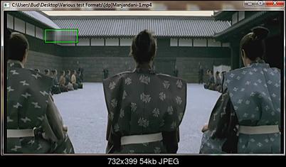

    Virtualdub is definitely the best way as redwudz mentioned. It has many filters to get various results. If you are into ffmpeg/CLI you can also specify the areas and get good results also. The following is a scrap video and an arbitrary area as denoted in the delogo area. This image is just to help define the actual script shown later.

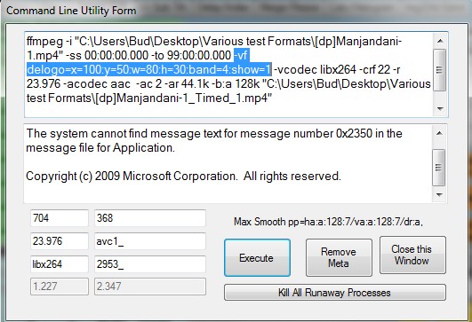

    The script has show=1 to display the green boundary for example. It can be left off to eliminate.
    ffmpeg -i "C:\Users\Bud\Desktop\Various test Formats\[dp]Manjandani-1.mp4" -ss 00:00:00.000 -to 99:00:00.000 -vf delogo=x=100:y=50:w=80:h=30:band=4:show=1 -vcodec libx264 -crf 22 -r 23.976 -acodec aac  -ac 2 -ar 44.1k -b:a 128k "C:\Users\Bud\Desktop\Various test Formats\[dp]Manjandani-1_Timed_1.mp4"

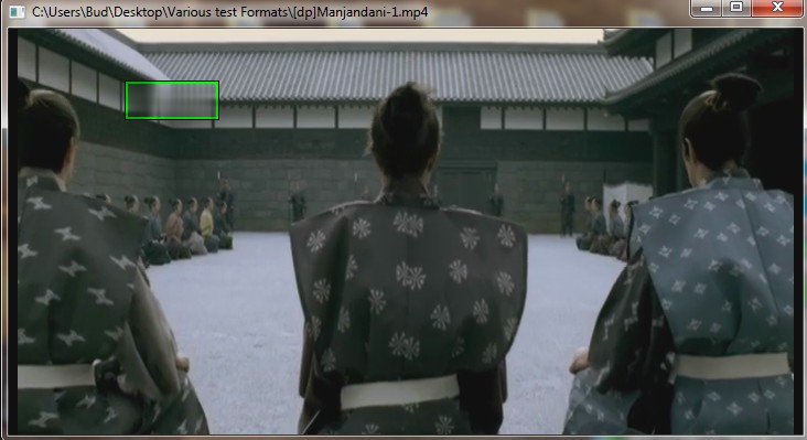

    And the final result below.
