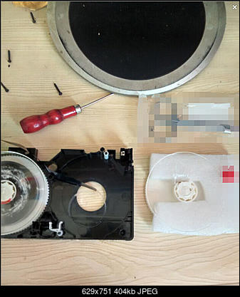

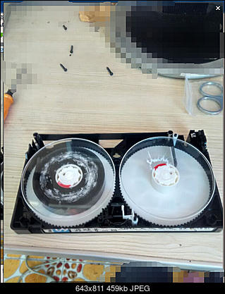

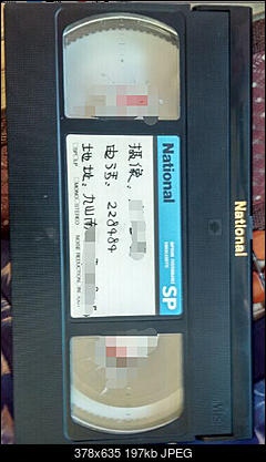

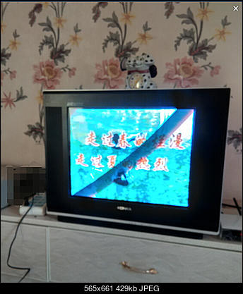

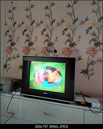

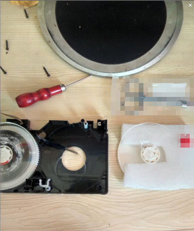

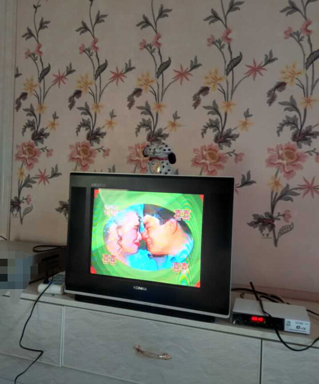

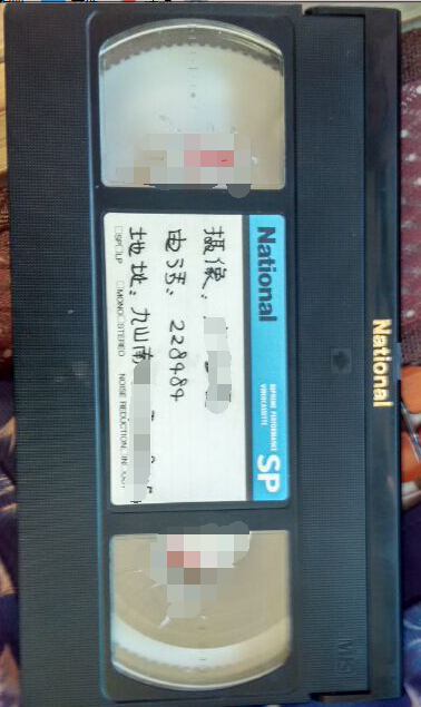

ID:	45251I can fix and capture to DVD (I have a tape repair method provided by JVC). The method I use for removing mold does not have any toxic substances. The price is only $30.
  10. VHS is easy to clean because the tape is thick. Camcorder tapes like Hi8 and Video8 are hard because they are thin.
  11. This tape was a marriage of a friend of a Zhejiang Province, China, who was married in 1993. When it was sent to me, it could not be played, and it was badly magnetized. After repairs, the capture effect was satisfactory.
