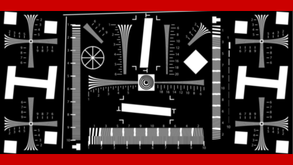

  7. Here is a function that crops, then resizes to match the size of a 'master' clip so the clips can be spliced together.
    Note, this function does additional cropping - beyond what you ask for - to preserve aspect ratio (see example below).
    Example: need to crop out 16 lines top and bottom, then resize to original size.
    CropMatch(Last, Last, 0, 16, 0, -16)
    [Attachment 43170 - Click to enlarge]
    [Attachment 43171 - Click to enlarge]
