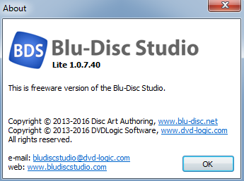

  8. aBigMeanie aedipuss's Avatar
    Oct 2005
    666th portal
    i know it works fine. i've authored many blu ray discs with it. the version i have is freeware.Name:  2017-09-17_175418.png
