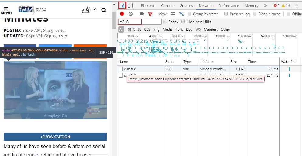

  2. I suspect this is spam. But in case it's a real query... m3u8 link found with browser's developer tools. Download with youtube-dl:
    youtube-dl "https://content.uplynk.com/68919b57cd1840e3bb2cb4b13983273a.m3u8?uid=68919b57cd1840e3bb2cb4b13983273a&autoplay=1&live=0&v=2&m.sound=normal&m.playback=autoplay&img=https%3A%2F%2Fstgec-ausw.uplynk.com%2F80C078%2Fausw%2Fslices%2F689%2F44c3f81cadf84cf5a6f4e6d100388208%2F68919b57cd1840e3bb2cb4b13983273a%2Fposter_9329a417eeeb4de6b0d29c8ab1f9b058.jpg&ad.cping=1&referer=assets.scrippsdigital.com"

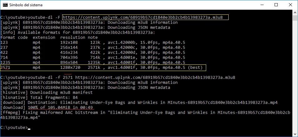

  10. joseph123 .. In youtube-dl
    Use the jagabo link : https://content.uplynk.com/68919b57cd1840e3bb2cb4b13983273a.m3u8
    [Attachment 43135 - Click to enlarge]
    And you will get the video in the youtube folder

  12. Originally Posted by joseph123 View Post
    youtube dl doesn't work for me
    when i click on youtube dl it show for 4 sec then it close alone.
    You can't double click on youtube-dl.exe to run it. You have to run it from the command line.
