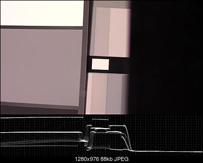

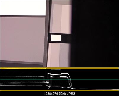

    How about this one?
    Brights start out a bit bright (very common with camcorders), blacks are fine:
    After about 20 frames the brights come down a bit, maybe 238 or so..
    Note that the waveform graph is 256 lines tall -- one line for each Y value. If you really think "a scope without a graticule is pretty useless" you can used VideoScope() intead of Histogram(). Frame 40:
    Again, the graph is 256 lines tall.

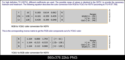

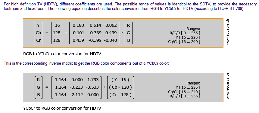

    Originally Posted by chris319 View Post
    I read each pixel in this RGB image and apply the bt.709 coefficients to arrive at luma values which are plotted on the scope.
    You would normally use the limited range matrix for this to compress the range from RGB 0-255, to YUV 16-235. No out of range YUV values are possible.
    http://www.equasys.de/colorconversion.html

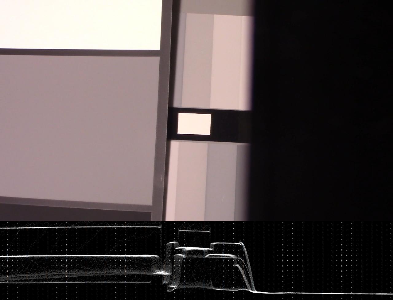

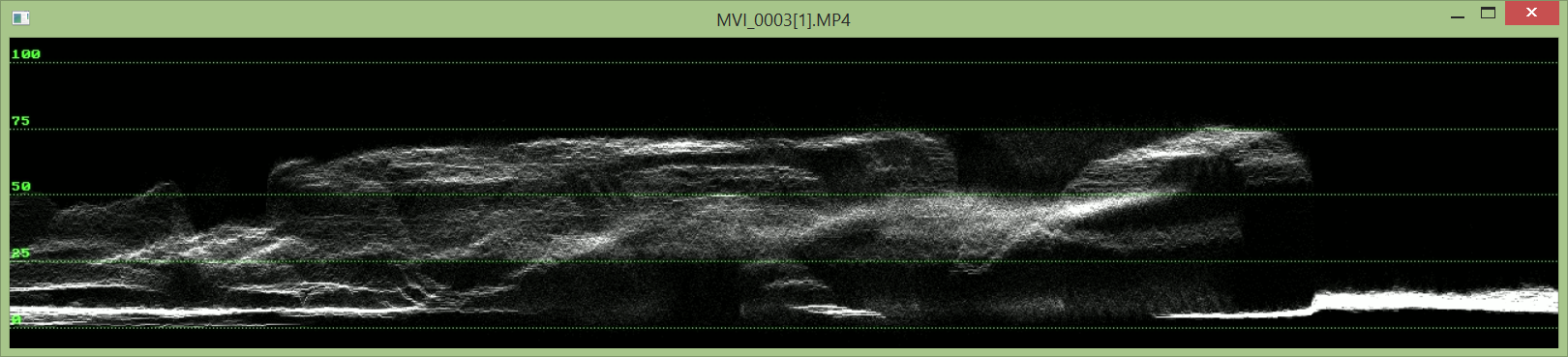

  10. ok here is another option , ffplay , from ffmpeg
    ffplay "MVI_0003[1].MP4" -vf waveform=scale=ire:graticule=green:flags=numbers+dots
    [Attachment 43205 - Click to enlarge]
    There should be a way to stack the corresponding video image with the waveform
    EDIT: maybe here
    https://trac.ffmpeg.org/wiki/FancyFilteringExamples#waveform
    And I checked it displays values <0, >100 IRE with full range video
    When you have a chance I would try to get avisynth working , maybe with lsmash. Avisynth is a very handy tool, especially with avspmod

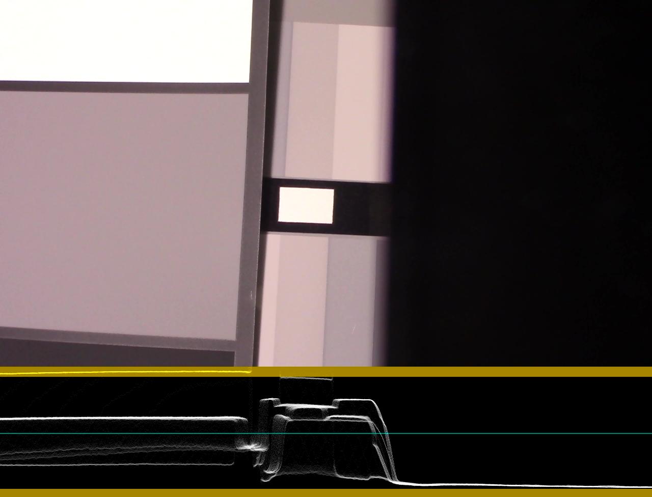

  11. You guys are going way too far astray.
    I didn't say anything about YUV. I don't know where you got that notion. You're confusing yourself.
    The video delivered to my scope program is ultimately RGB, and apparently it's 0 - 255 and doesn't match what the camcorder is recording. What gets recorded internally in the camcorder is a black box to me. All I know is it's 16 - 235.
    You can conjecture all you want about my particular DirectShow setup, etc. but it's one use case out of millions. We know that escapi interfaces to DirectShow, which AFAIK is a standard-stock Microsoft Windows 10 setup.
    My scope program is read-only. It doesn't alter levels and doesn't write them to anything other than the screen display.
    All I have to do is adjust my scope program to accomodate 16 - 235 and it will match what gets recorded.

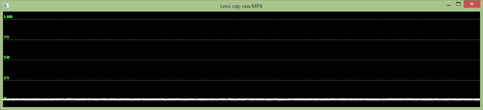

    Trust me, I know how you feel x10 . Go back a few years and read my complaints. I had to revisit it many many many times. There are a gazillion "gotchas" and little quirks. But it's well figuring it out eventually. Very useful tool
  14. Black level is a little above Y=16. The lowest Y value I saw is 15, the highest 28. Most pixels are between 18 and 22.
    I just looked at the file "lens cap raw.mp4" using the ffplay scope. Sorry, the video noise floor with a capped lens is roughly at digital 0. It is well below 16. This agrees with what my own scope program sees out of the HDMI output. I can vouch for my scope program because I wrote it and I know what the calculations are. So no, it is not putting out one set of levels for HDMI and recording another. It is not putting out broadcast-legal 16 - 235 which is par for the course for a consumer camcorder.
    See for yourselves:
    bin\ffplay "lens cap raw.mp4" -vf waveform=filter=lowpass:scale=ire:graticule=green:flags=numbers+dots

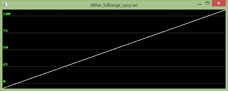

  15. Originally Posted by chris319 View Post
    See for yourselves:
    Are you looking at the correct video ?
    Your lens cap video. Notice everything is above IRE 0, or Y=16 . There might be some stray pixels slightly below, from compression artifacts (it's a lossy recording after all)
    [Attachment 43212 - Click to enlarge]
    This is a true full range with "well below digital 16". Notice it goes below IRE 0, and above IRE 100. So below Y=16 and above Y=235
    [Attachment 43213 - Click to enlarge]
  16. Originally Posted by chris319 View Post
    No, it is at IRE 0. URE=0 is Y=16, IRE=100 is Y=235.
