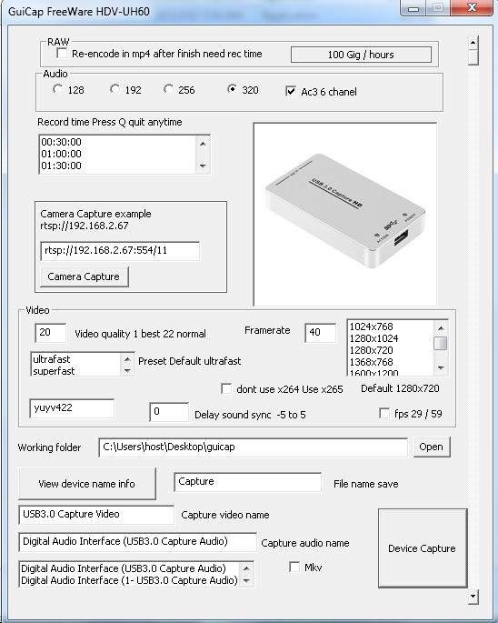

i have buy a usb 3 capture device HDV-UH60 they have different name on ebay and aliexpress
i try vlc, obs, pin. studio, corel studio all working but sound have a delay of 3 second
i fix the sound out of sync
gui made by me in c+
enjoy if you have that device...
if you have other device just change the name and name of audio capture

update fix sync audio work fine with my pc
submit your bug thank!Last edited by codebox; 21st Sep 2017 at 21:57. Reason: update
[Attachment 43252 - Click to enlarge]
work best with SSD disk, flow capture speed
-fix some bug
-add ac3 6 chanel audio capture
-add raw capture 100 200 gig houre for nut.
final portable version
