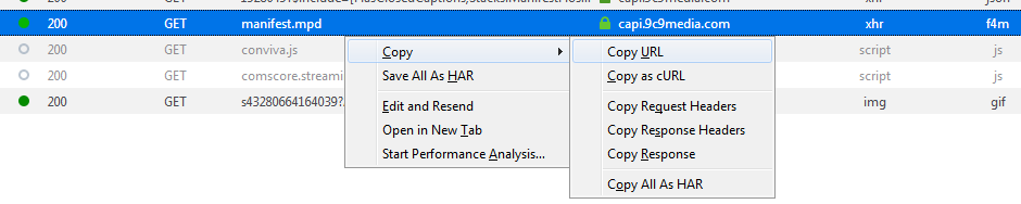

  13. I was using Internet Explorer. In Firefox try looking for a manifest.mpd f4m link instead. Copy the URL:
    Then youtube-dl.
    youtube-dl https://capi.9c9media.com/destinations/mtv_web/platforms/desktop/contents/1338887/contentpackages/1928049/manifest.mpd
  14. Originally Posted by jagabo View Post
    [Attachment 45137 - Click to enlarge]
    Then youtube-dl.
