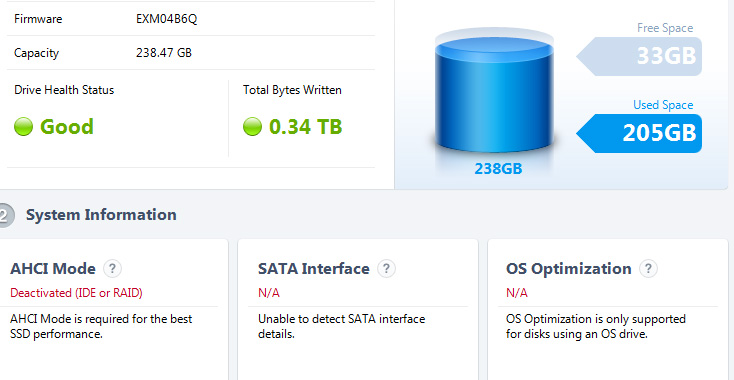

    My vista 32bit machine has the gigabyte P-55 motherboard. I added an SSD sata drive for high res photo editing.
    When copying a folder of photos or movie in that same ssd.
    I usually get only 135-150MB/s for a folder of photos each photo around 100-300MB size.
    When copying a HD video file like an .mov I get around the same sometimes peaking to 150MB/s
    The above is the same roughly for both my SATA 2 & SATA 3 connections, however crsytal diskmark sata2 is alot slower. (252MB/s seq vs 350)
    In samsung magician it looks to say I have no AHCI mode i think? Could that be the reason the ssd is slow?
    [Attachment 43108 - Click to enlarge]
    Do you think this is just an old machine or a driver issue? Looking at the drivers on this page,what should I try & download.

  4. I would try downloading the AHCI driver and install it then reboot and go into bios and enable the AHCI mode
    hopefully it will reboot okay and go like the clappers

    My SSD is the boot drive so I guess I turned on AHCI mode in the bios BEFORE I reinstalled windoze. I also read that if AHCI mode is not turned on BEFORE installing Windows for versions higher than XP (since it is not supported out of the box) it will result in a BSOD if you attempt to turn on that BIOS setting after the install unless you do some registry hacking. Not for me to even go down that road.
    But since the OP does not appear to have the SSD as his boot drive the above might not apply. Just do not blame me if you get a BSOD. You have been duly warned tho.

    ahci shouldn't change the speed of the connection. ahci only adds ncq and hot plugging. what i see is weird is that his system report says he has no sata ports so is the ssd hooked up to an ide port with a sata to ide adapter?
    Mar 2015
    melb
    Nope, its through a real sata port. I got 6 sata II & two sata III ports.
