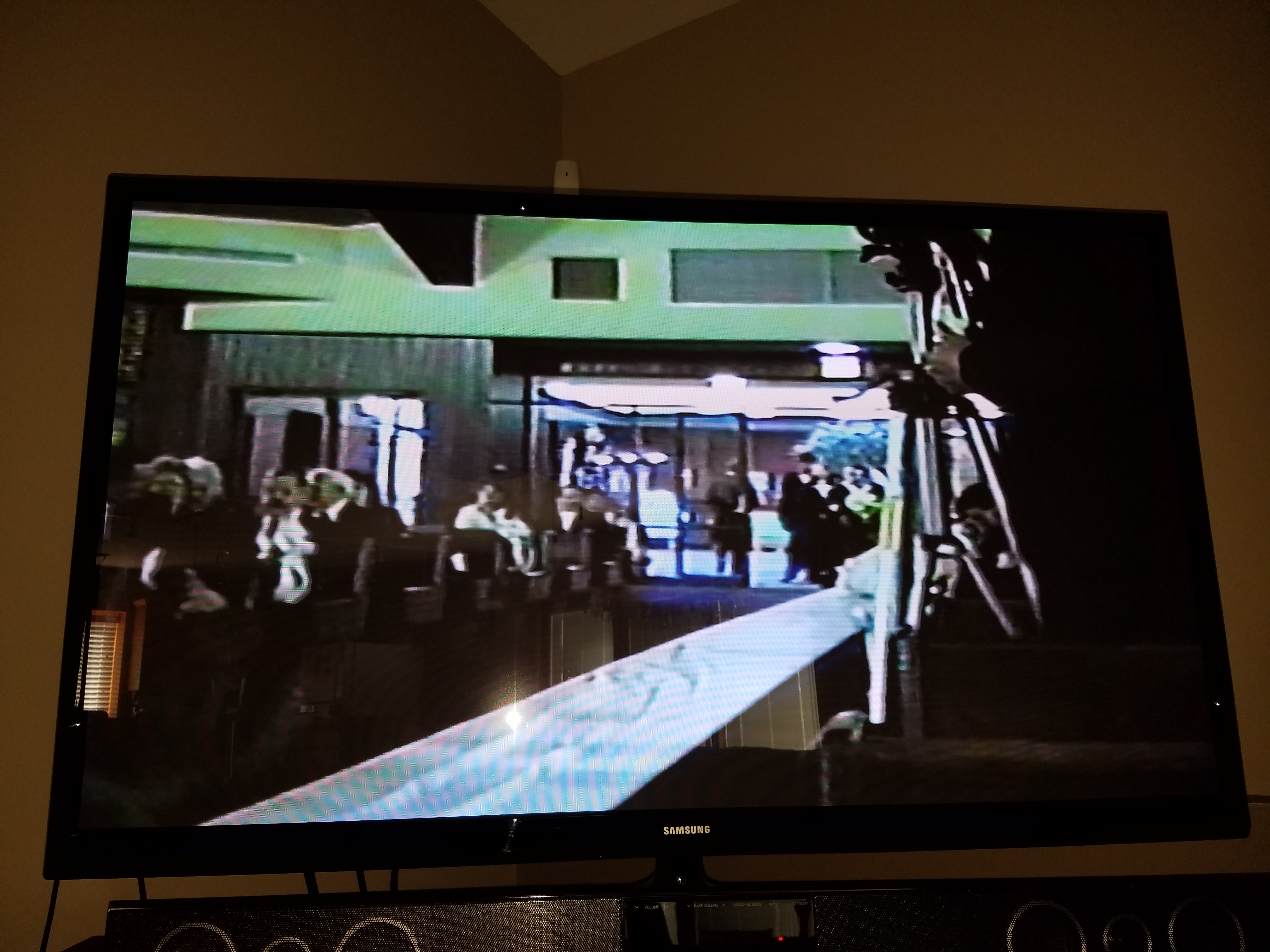

  3. Converting it is probably my best option. With the settings mentioned above (4:3, automatic or letterbox) however, the pictures fits the screen with very little cropping.
    What is a good piece of software to convert to 4:3 to 16:9? After converting it what would be the best video resize option to use?
  4. Image
    [Attachment 43105 - Click to enlarge]
    This is what the screen looks like with those settings
  5. Originally Posted by JasonQuinn1992 View Post
    I want to keep the aspect ratio that it was shot in (4:3 Full Screen) intact, but I want the finished DVD picture to fill up my DVD screen upon playback.
    An impossibility, don't you think? You want to keep the 1.33:1 aspect ratio but at the same time you want it to fill a 1.78:1 television screen.
    Just encode it as 1.33:1 (4:3 keeping the full and complete video) and use the zoom on your remote control if you insist on filling your screen. Maybe some day you'll want to see the entire picture and if you've already removed 25% it it by cropping from the top and bottom, it'll be gone forever.

    Yeah, it seems impossible. Seems like keeping it and zooming is my best option. I guess what I'm wondering is if I have the settings as 4:3 and Automatic or letterbox, why does my TV blow up the picture to fit the screen?
  7. Originally Posted by JasonQuinn1992 View Post
    First, leave all 4:3 settings at Automatic. But you seem to be saying it turns all 4:3 DVDs into widescreen DVDs no matter if set for Automatic or for Letterbox. If so, that's an issue with your television. Some crappy models stretch everything to fill the screen. More likely it's some some sort of format or aspect setting you've set up incorrectly. Play around with your aspect ratio settings. Maybe you turned the zoom setting on at some point. What they're called varies by brand name so I can't be more specific than that.
