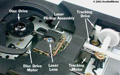

    The laser looks something like this:
    Image Attached Images
