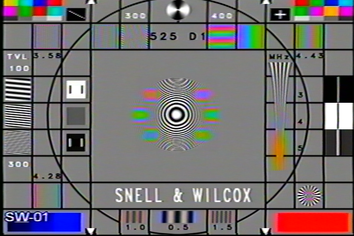

    When I capture using the Shuttle with no processor and using composite output, I get lots of noise (like the picture of the Snell & Wilcox using the s-video to tv below the 300 & 400 boxes). Must be my t.v has a decent comb filter as there is no or low noise using composite.
    I know I said I'll be capturing vs actually real-time viewing my laserdiscs. I just wanted to show an example of the noise. I would like my captures to look like the picture with using composite.
Name:	S&W composite.JPG
Name:	S&W s-video.JPG

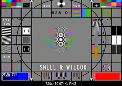

    I don't have a video handy that shows the pumping but here one of a couple Snell & Wilcox charts -- captured from a DVD player. It's so clean you would be tempted to think it was an s-video cap. But you can see composite rainbowing during the transition from one chart to the other (the 3d part of a 3d comb filter only works in still parts of the frame, for moving parts it resorts to 2d filtering).

  27. Note that the time base on a typical VHS deck isn't good enough for a 3d comb filter to be useful. Here's the same test pattern as earlier, recorded from the DVD to VHS tape, then captured from the tape with the ATI 650:
    Laserdisc should have better time base than that but it will not be rock steady like a DVD. So you'll probably still get some rainbowing.

    There are some software algorithms that use advanced techniques that give sharp edges without much aliasing (they work especially well with cartoons) -- but you'll have to learn AviSynth. And your LD source is almost certainly telecined film. For the best results you want to inverse telecine back to film frames, then upscale. That will give much better results than directly upscaling interlaced frames.
    Using a hardware upscaler is a mistake if you want the best quality. It's the fast easy solution for mediocre quality.
