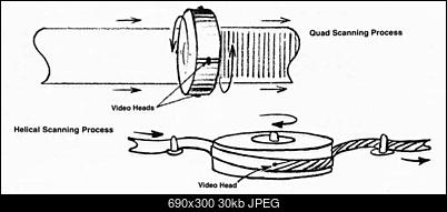

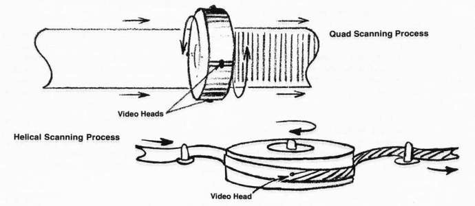

    Really cool tape machine and tape content. It seems to have mostly good horizontal stability during the intro with the NASA logo and picture of Earth, without having a TBC I assume. Might be because it does not use a Helical scan head like VHS, but instead a stationary head similar to a cassette deck.
    Aug 2010
    San Francisco, California
    The quadruplex format does not use a stationary video head. There are four heads mounted on a drum spinning perpendicular to the direction of tape travel. The tape is not wrapped around the drum, like helical, but sucked into a concave shape by a vacuum hose as it passes the drum, ensuring head contact from top edge to bottom edge.
  4. Dinosaur Supervisor KarMa's Avatar
    Jul 2015
    US
    The tape in the youtube video was moving pretty fast by my standards so I just assumed it was linear. Never really thought about the quadruplex scanning. Pretty interesting.
