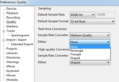

    Thanks. In audacity, preferences=> quality => Dither: There are four options, viz. None, Rectangle, Triangle, Shaped. Which one do you suggest? The default is 'None" There is another parameter listed under 'High-quality conversion' Dither which also has the same four options. The default is found to be 'Shaped'. I have not changed anything.
Name:	audacity preferences.jpg
  17. I would leave it default, but you can test them and see if you can "hear" the difference. You won't be able to at normal bitrate ranges (for very low bitrates with lossy compressed audio you might). But dithering differences are detectable with various programs
  18. Member Cornucopia's Avatar
    Triangular is recommended for intermediate stages, Shaped is for final (not to be re-edited) output.
