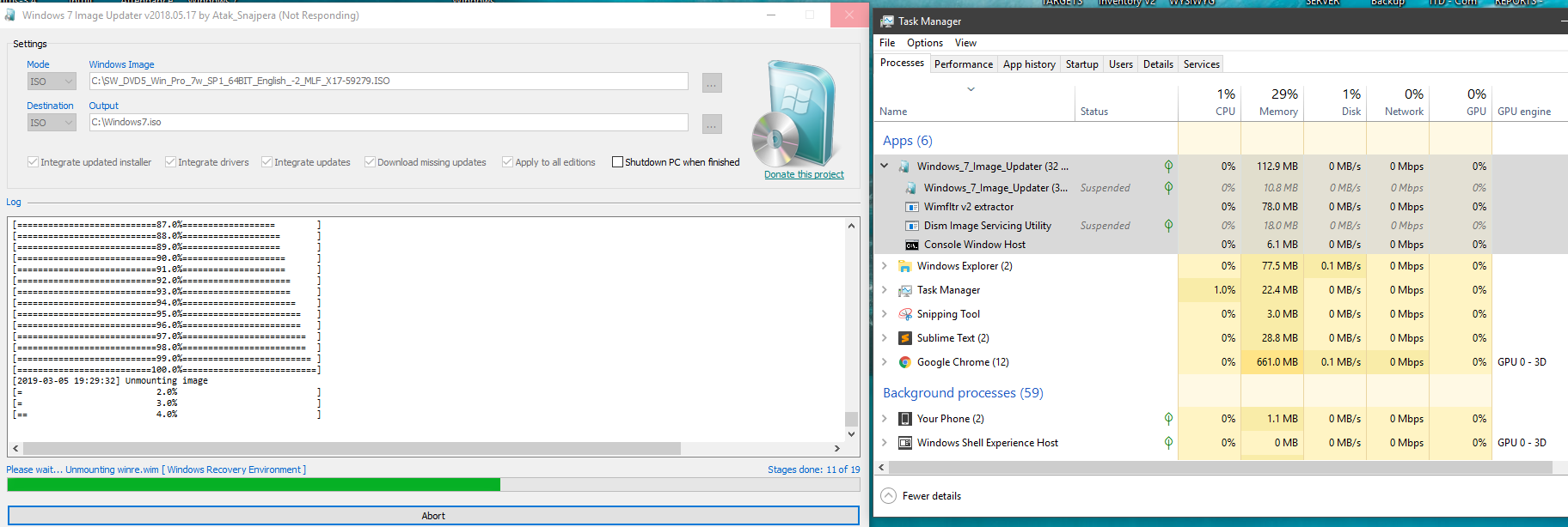

    Program getting suspended on windows 10 v1809, using the Orignial ISO from Volume Licensing Center and running on SSD.
    [Attachment 48282 - Click to enlarge]
