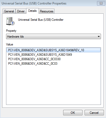

    everything works except USB VEN_8086&DEV_A36D&SUBSYS_A36D1849, please help?
  24. Originally Posted by temeljnik View Post
    There is no such dev number (DEV_A36D)

  25. Member
    Apr 2018
    croatia
    my motherboard is Asrock LGA1151 H310M-HDV M.2
  26. Show me what exactly you have in Device manager.
    take a screenshot

  28. Show hardware ids for each device with yellow triangle.

  30. PCI Simple Comunication Controller
    http://www.mediafire.com/file/svjyf5zf72zk6ts/MEI.7z
    Force installation via Device Manager (Update driver -> Browse My computer for driver -> Let me pick from list -> Have disk -> select heci.inf
