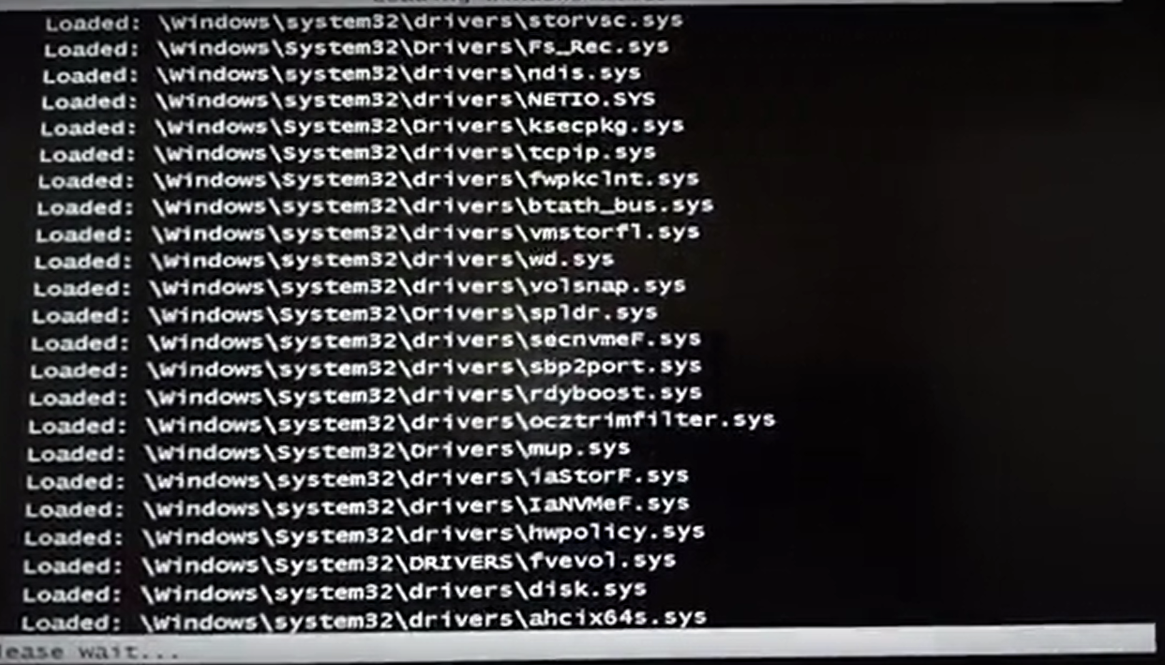

  16. Just registered to express my gratitude to the OP for preparing this awesome tool! U rock!
    Now about my case,
    I own a x570 Gigabyte Aorus Elite mobo with a Ryzen 5 3600x and I am trying to install win7 on a M2 Silicon power nvme disc.
    I have prepared the iso and I have some questions about running this:
    1) do I need any special drivers for my drive?
    2) do I need a ps2 keyboard? my mobo doesn't have any ps2 ports
    3) how to install it? should I just prepare a bootable usb and go ahead with the installation? will my usb mouse and keyboard work normally?
  17. Btw, if you only have issue with the NVMe support. try this tool.
    http://hdd.by/Victoria/Windows7-10PE.zip
  18. Originally Posted by lvpha View Post
    Are u writing to me?
    I have completed the installation but the windows don't load. What do u suggest?

  26. I suspect that you installed win7 without CSM mode enabled in bios. Updated win7 Has native support for nvme so you do not need 3rd party driver.
  27. Originally Posted by Atak_Snajpera View Post
    As you can see it's enabled.
    I have tried 3 different iso from different sources.
    Always the same problem: windows starts loading and then my pc reboots.
