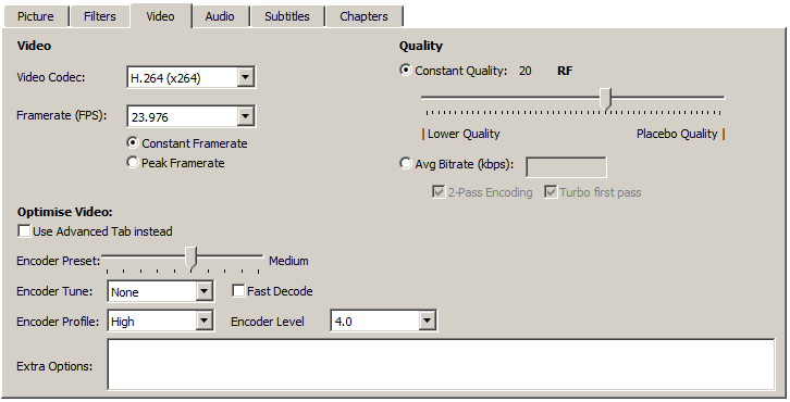

  4. ReFrames limit is implied by level. Just set profile to High and level to 4.0 (or 4.1).
    [Attachment 43011 - Click to enlarge]
    If it's too slow you can frag the preset slider more to the left. If you tell us your exact hardware (CPU and GPU model) and OS maybe someone can give you a hint about HW encoding. (or you do a forum search about it)
  5. Originally Posted by goodmehdi View Post
    and my notebook is core i3.how long to complete encode?
    Anywhere from minutes to days, depending on the settings you choose. Handbrake's Normal preset with x264 set at Veryfast will give you fair quality at a pretty fast speed (maybe an hour on your i3). If your laptop support QuickSync the Intel QSV encoder should be significantly faster with about the same quality as x264 veryfast.
  6. Originally Posted by sneaker View Post

  7. Originally Posted by goodmehdi View Post
    i should re encode this file?Is there a way i dont re encode and fix the original file?
    If it really uses 8 reference frames and your TV can't handle it -- you must reencode.
  8. Originally Posted by jagabo View Post
    tnx.i want my file encode to this:
    Format : AVC
    Format profile : High@L5
    Format settings, CABAC : Yes
    Format settings, ReFrames : 8 frames
    Codec ID : V_MPEG4/ISO/AVC
    Duration : 1 h 8 min
    Bit rate : 1 800 kb/s
    Width : 1 920 pixels
    Height : 1 088 pixels
    Display aspect ratio : 16:9
    Frame rate mode : Constant
    Frame rate : 23.976 (24000/1001) FPS
    Color space : YUV
    Chroma subsampling : 4:2:0
    Bit depth : 8 bits
    Scan type : Progressive
    Bits/(Pixel*Frame) : 0.036
    Stream size : 877 MiB (89%)
    this settings are ok?
    https://forum.videohelp.com/attachment.php?attachmentid=43011
  9. You don't want 8 reference frames. Your TV probably only supports High@L4.1 with Blu-ray limitations. At 1080p that's 4 reference frames.
