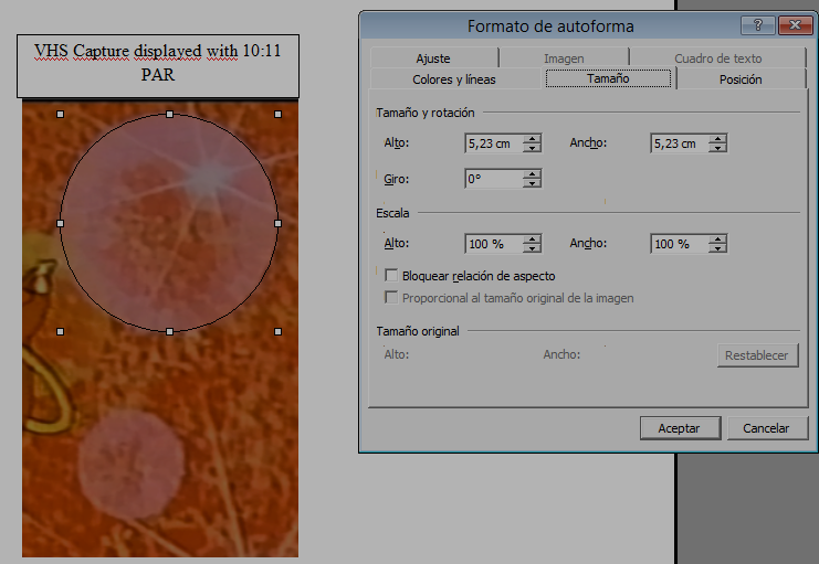

    Regarding my previous question on how to determine the type of source (ITU/MPEG), which I added in an edit while you were writing the reply (that was unlucky), I guess one can just check the shape of geometrical bodies, for example:
    In the case above the error of assuming 10:11 SAR is very little, as desired. In the case of that source, since it's a (direct) VHS capture, it could also be argued that the MPEG2 way doesn't apply.

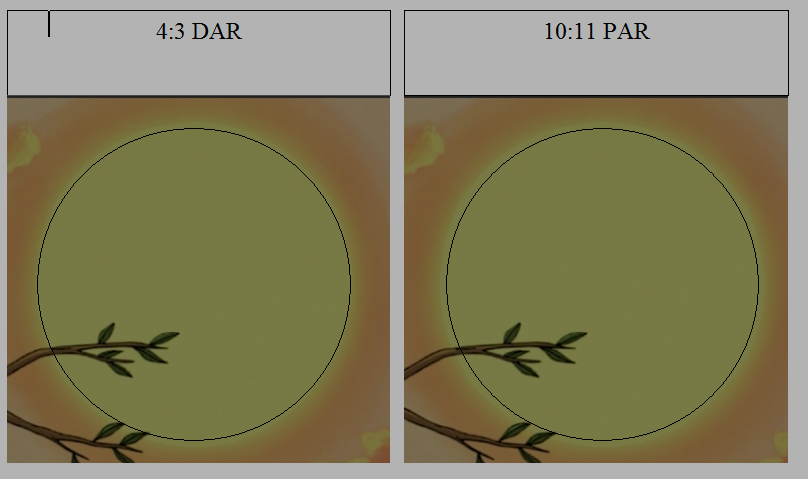

    I applied the test to a DVD source:
    Although this is a mere qualitative analysis, it can be seen that this DVD needs to be resized / encoded assuming the ITU specs.
  8. Analog video capture almost always follows the ITU spec, even if it's direct to MPEG. The difference between the ITU spec and the MPEG spec is mostly ignored by the DVD industry. When DVDs are made from analog tape they capture with the ITU spec and just write the 720x480 frame to the DVD flagged as 4:3 DAR. Finding an object of known aspect ratio and measuring it like you did above is the best method to determine the correct aspect ratio. In the absence of that you can look for other hints. ~8 pixel wide back bars at the left and right of the frame are a pretty good indicator of an ITU cap. A not so sharp image is a pretty good indicator that the source was video tape and hence is a ITU cap.
