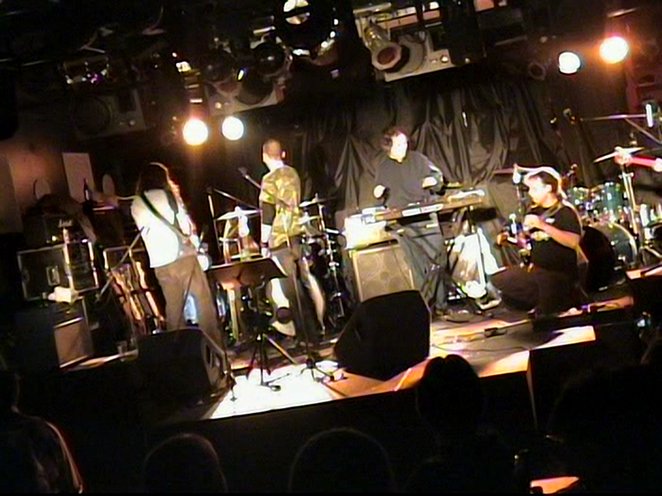

    the MPG is a bad transfert from DV cam to dvd recorder (probably rca audio and 1/8 jack for video)
    I can't reshoot this. i have lots of dvd transferd this way (not by me)
    i know the whites are blown (IRE) (any alchemist are welcome if they can tranform lead into gold)
    the Avi was made using this script -
    OUT_SAR_X = 10
    OUT_SAR_Y = 11
    video = MPEG2Source("E:\DVD_VIDEO_RECORDER\DVD_RECORDER.in dex\DVD_RECORDER.d2v", cpu=6, info=3)
    audio = NicAC3Source("E:\DVD_VIDEO_RECORDER\DVD_RECORDER.i ndex\DVD_RECORDER T80 2_0ch 256Kbps DELAY 0ms.ac3")
    AudioDub(video, audio)
    AssumeTFF()
    ConvertToYV12(interlaced = true, matrix = "PC.601")
    ColorYUV(off_y=-8, gain_y=-14)
    AutoAdjust()
    QTGMC(Preset="Slow", Sharpness=1.0)
    TurnRight()
    QTGMC(Preset="Slower", InputType=3, ProgSADMask=2.0)
    maa2()
    TurnLeft()
    QTGMC(Preset="Slow", InputType=3, ProgSADMask=2.0)
    maa2()
    srestore(Frate=29.97)
    ConvertToYUY2(ChromaInPlacement="MPEG2", matrix = "Rec601")
    TemporalSoften(2, 5, 8, scenechange=15, mode=2)
    Spline36Resize(720, 480)
    i think it's a little over-filtred i'm loosing details (their isn't much)
    i wanted to cleah up vertical and horizontal lines visibles around edges
    i can see them well if i zoom to 400% (with virtualdub or aviuti)
    my end goal is to make an edit-friendly file (probably prores422) for a 2 cam projet
    i have another source that i've deshakened with enough succes
    any suggestions?

    when zooming in on the edges, it looks like the old -lite bright- game ....BIG square pixels ..stairways everywhere ...i just want to smooth that out or correct it i don't see any solutions
    that's why i've haded temporalsoften at the end of my script ...if i had a solution for my BIG pixels thing i'd removed it
    I used cpu=6 ..does deblocking kill detail?
    Would seesaw() help for the jaggies or shimmering?

    i still get horizontal and vertical shimmering and their are still stairways everywhere ? no real solutions?
  13. I didn't find anything that would eliminate the shimering without otherwise damaging the picture.
    Those sawtooth edges are a hallmark of many consumer video cameras, both analog and DV. Tends to look worse with DV sources. I hate that noise, and even the best of gurus I've found have no solution for it any better than dropping alternate fields. That's what I tried with QTGMC (FPSdivisor=2), and used RemoveDirtMC to smooth most of the shimmer. The results still worked when I lied to my encoder, told it the video was interlaced, and encoded it for standard def BluRay. Likely wouldn't be so great for a sports video. Too bad about the fried brights, another DV signature.
    Import("Drive:\path\to\ContrastMask.avs")
    Import("Drive:\path\to\RemoveDirtMC.avs")
    Import("Drive:\path\to\Santiag_v16.avs")
    vid=MPEG2Source("Drive:\path\to\DVD RECORDER.d2v")
    aud=NicAC3Source("Drive:\path\to\DVD RECORDER T80 2_0ch 256Kbps DELAY -12ms.ac3")
    AudioDub(vid,aud)
    ColorYUV(gain_y=-22)
    SmoothLevels(16,0.75,255,16,255,protect=6)
    ContrastMask(enhance=3.0)
    AssumeTFF()
    QTGMC(preset="medium",FPSdivisor=2,GrainRestore=0.5)
    Santiag(3,3,type="sangnom")
    RemoveDirtMC(20,false)
    Spline36Resize(720,480)
    LSFmod()
    return last
    - My sister Ann's brother
  16. I took a shot at the MPEG version using a convolution filter with a
    1 2 1
    2 4 2
    1 2 1
    matrix. I then followed that with an inverse gamma function to try to squeeze little more out of the highlights. I then ran that through my own histogram function to further adjust the highlights and gamma. It might look a little blurry up close, but I don't think I lost too much detail. Even if it isn't exactly what you want, it shows you some of the possibilities of a convolution approach. It is well-suited for removing or blurring horizontal or vertical lines.
    Here's the result (I kept it interlaced):
    Convolution Blur, etc.
    You can also play around with these functions which someone suggested to me for removing much stronger vertical lines in Polavision film transfers (Polaroids instant movie film from the late '70s).
    function Fix1 (clip c)
      TurnRight(c)
      Merge(Yadif(0,1),Yadif(0,0),0.5)
      TurnLeft()
    function Fix2 (clip c)
    TurnRight(c)
    Merge(Merge(RemoveGrain(15),RemoveGrain(16),0.5),Merge(Yadif(0,0),Yadif(0,1),0.5),0.33)
    TurnLeft()

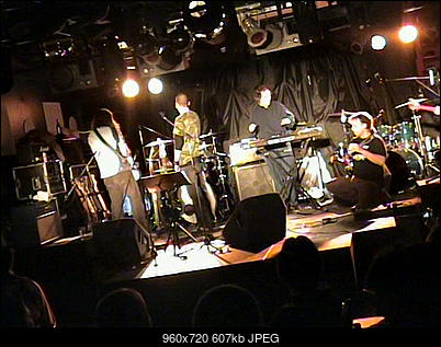

    i uploaded a snapshot the video file didn't upload.. well did upload but didn't made it
    Complete name : E:\VEGAS\DVD_RECORDER.index\New Folder\DVD_RECORDER_1.mov
    Format : MPEG-4
    Format profile : QuickTime
    Codec ID : qt 0000.02 (qt )
    File size : 27.6 GiB
    Duration : 20 min 11 s
    Overall bit rate : 195 Mb/s
    Encoded date : UTC 2018-04-23 10:33:27
    Tagged date : UTC 2018-04-23 10:33:27
    Writing application : Lavf58.10.100
    Video
    Format : ProRes
    Format version : Version 0
    Format profile : 422 HQ
    Codec ID : apch
    Bit rate mode : Variable
    Bit rate : 195 Mb/s
    Width : 960 pixels
    Height : 720 pixels
    Display aspect ratio : 4:3
    Frame rate mode : Constant
    Frame rate : 59.940 (60000/1001) FPS
    Color space : YUV
    Chroma subsampling : 4:2:2
    Scan type : Progressive
    Bits/(Pixel*Frame) : 4.715
    Stream size : 27.6 GiB (100%)
    Writing library : Lavc
    Language : English
