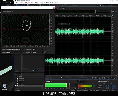

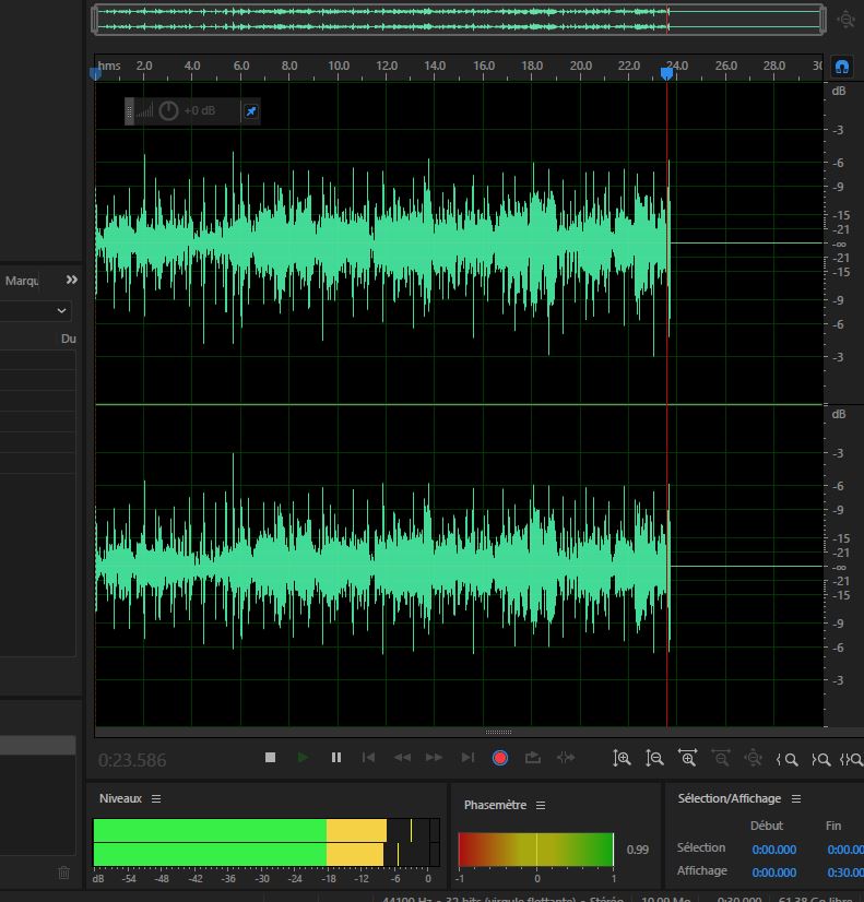

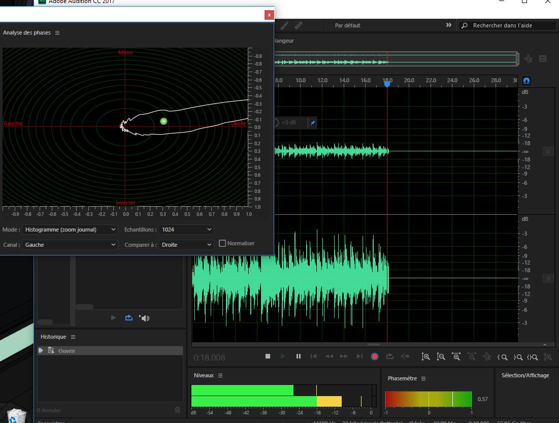

    Hi,
    when I record a vinyl, my balance level isn't the same left & right
    is it normal and how to adjust it pls?
  2. First this can be signal that something with your setup is not correct - check spectral characteristic - perhaps there is asymmetry in frequency response, second use monophonic recording - perhaps some test vinyl and try to verify correctness of your setup - small difference (imbalance) between channels can be difficult to fix and can be corrected by introducing different gain for channels (un-tick "lock left/right channel" in Amplify/fading processing) .
    Automatically this can be easily fixed by selecting normalization (to -3.0103dBFS) independently for channels - you need to verify if your panorama is correct (select proper plot - phase analysis Alt+X - plot Histogram - will show imbalance between channels in nice way).

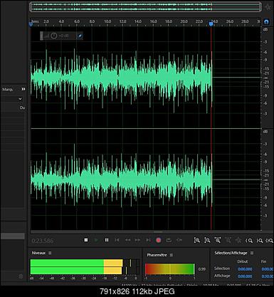

    Can I set the balance level separately by using the ''preference'' menu >audio material, and go to my setup like this? I tryed it manualy and the result is good on visual. I sat 75 rather than 60. (pls see pic 1&2)

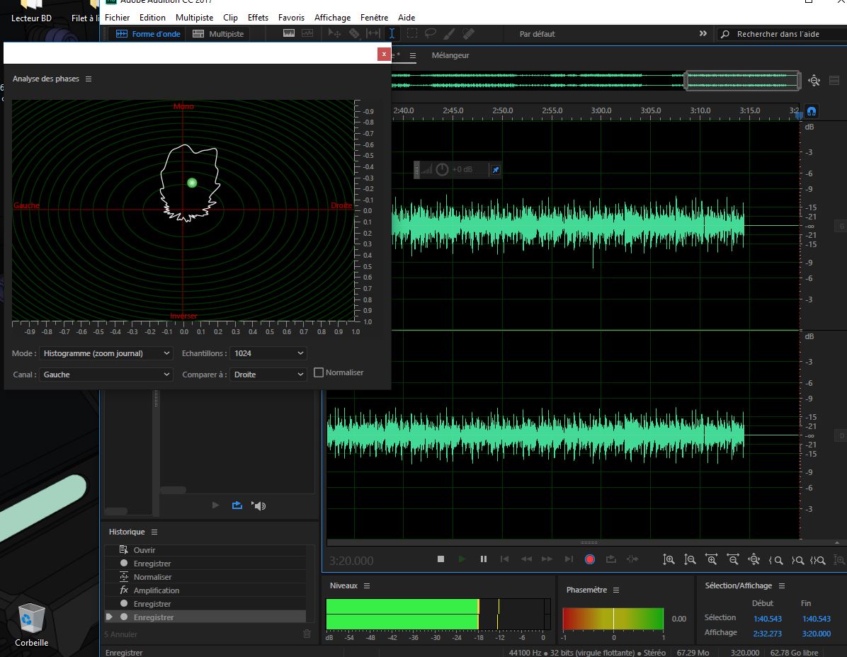

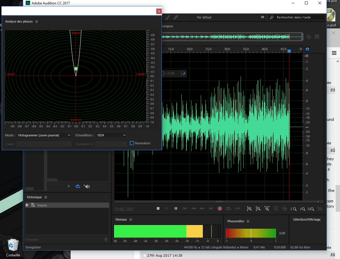

    About Alt+X:
    can you see something wrong in the histogram plot you can see in 3rd pic? (on this pic I sat the balance level to 60 & 60, that's why you see unbalance again).
    About normalizing for each channels separately:
    I succeeded to normalize to -3 but both channels haven't got identic peak.
    Perhaps ''introducing different gain for channels (un-tick "lock left/right channel" in Amplify/fading processing)'' is the correct way?
    I get this, but I get it trought the menu >effect >amplitude & compression > amplification (pls see pic#4)

  4. Seem this is newer version of Audition, by Alt + X i mean "Phase Analysis" window and active "Histogram".
    Balance can be achieved on many ways - if you prefer own way fine for me.
    btw this is how Phase Analysis looks - first picture - Russian page - didn't found anything except this one.
    http://wikisound.org/Adobe_Audition_Phase_Analysis

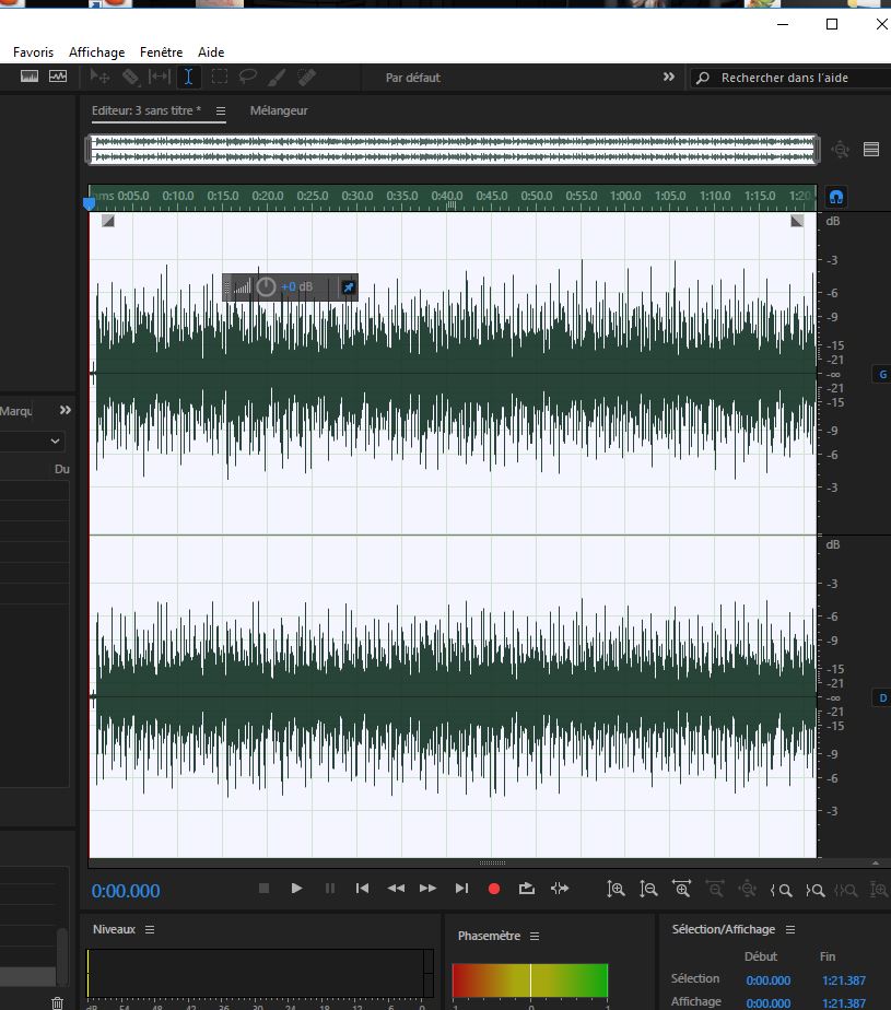

    First check with a mono recording to check your setup and balance levels - they should be the same. Stereo recordings can and are mixed with different levels between left and right but not dramatically so. I had to "remix" a source on 4 track multi-track tape original destined to mono release to "stereo" The producer wanted the piano totally on hard left and the drums hard right with the bass and acoustic guitar in the middle. The result was a big imbalance between the left and right but helped a bit by having the bass and guitar in the middle. The result was not so much stereo but more 'lateral placement' of instruments. There can be big differences so you need to calibrate your system first. Then there is correct phasing of microphone leads but that's another story
    Aug 2014
    Switzerland

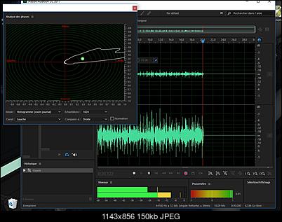

    here is a mono recording with a stereo 12''EP and phase analysis:

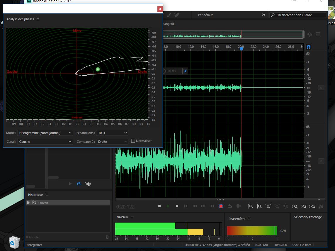

    here is a stereo recording with same stereo 12''EP and phase analysis:
    here is a stereo recording of a mono 7''EP, and phase analysis:

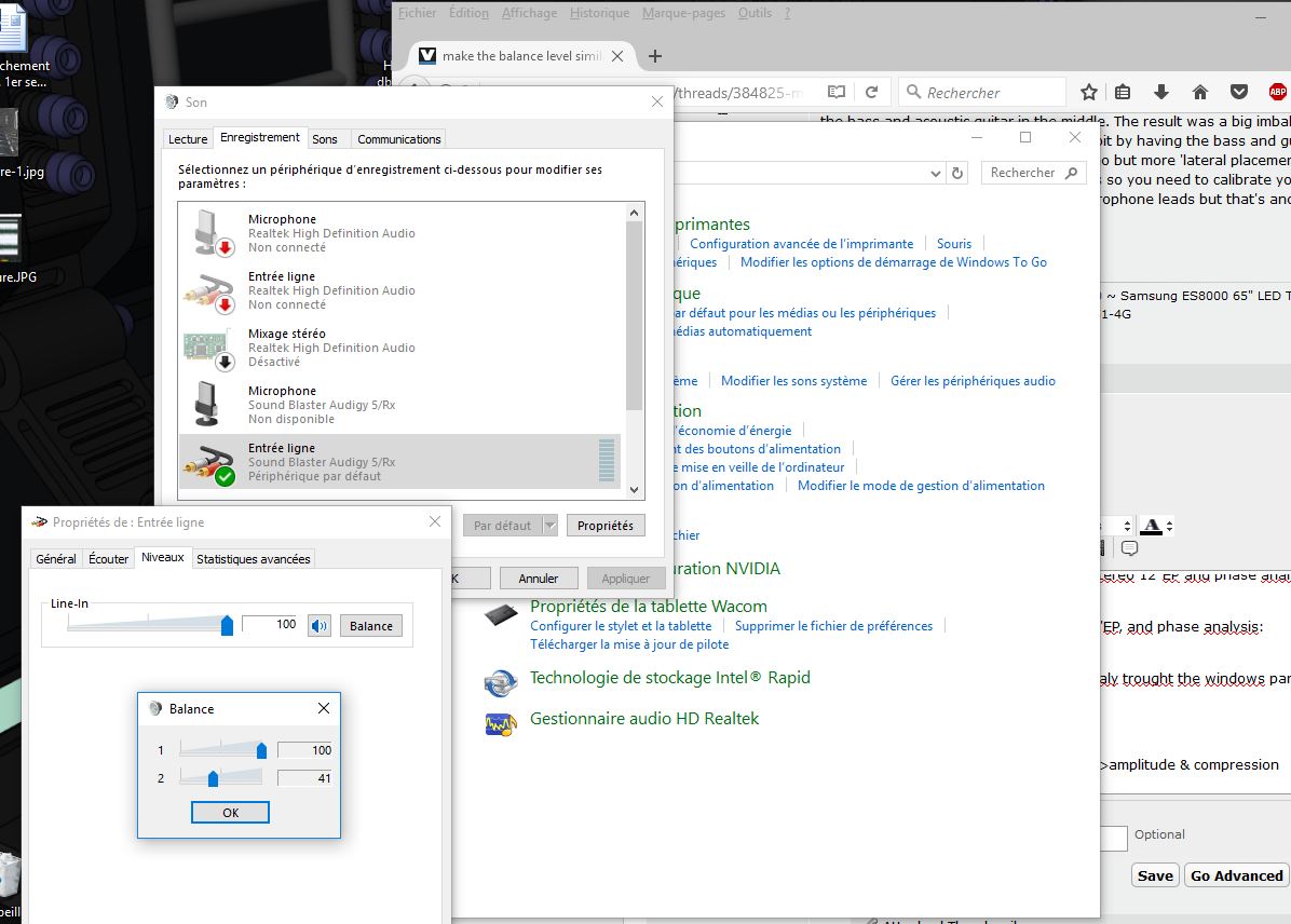

    And here, I sat the balance level manualy trought the windows panel to 100/41

  7. It looks like something is wrong with your setup - you can set balance directly on input mixer for your audio card - perhaps is wrong? If this is not source of problem for this then you need dig more - perhaps pickup, perhaps wiring, perhaps preamp... I assume for mono recording - imbalance between channels shall be not higher than 3dB.
    Aug 2014
    Switzerland

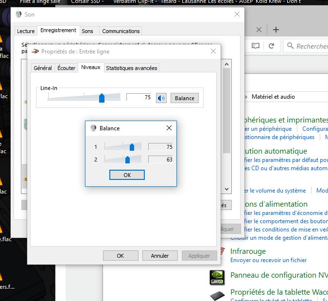

    I notified one channel of my wire wasn't corrected fixed. When I moved it a bit, things changed:
    Here is a new stereo record of a mono 7'' EP

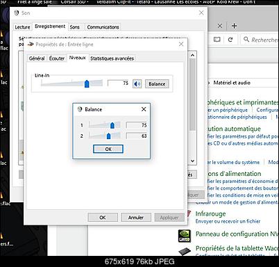

    With this level setting: now I don't've to go until 100 for having enough sound, and don't've to put right speaker to 40 for having good balance.
    And thoses are my settings in Audition, but I have other options, like:
    Input:
    ''What I am actually hearing (Soundblaster Audigy 5/RX)''
    ''Microphones''
    Output:
    ''Speakers (Soundblaster Audigy 5/RX)''
    ''Speakers (USB Audio Codecs)''
    ''Realtek Digital Output (Realtek High Definition Audio)''
    My pre-amp have a gain pot, but I can't use it with my actual pc, but when I tryed with my laptop, it worked fine.
    http://www.project-audio.com/main.php?prod=phonoboxusbv
    I use some wires like these, but they are hard to put well in the holes, because the holes are very tight compared to the tickness of the tip of the wire.
    http://www.audioquest.com/bridges-falls/golden-gate
    p.s. how to access to the input mixer of my audio card pls?
  9. So seem it was connector issue, plenty if not all decent RCA connectors are very tight fit in a socket - usually it is not a problem as they are not frequently reconnected.
    Seem also you already have access to Input mixer - this is called on your picture (my French is almost not existing) 'Line In Properties' this is where you can configure input level and balance between channels in (i assume) analog domain so in proper place - adjusting them in digital domain i.e. Audition is not optimal.

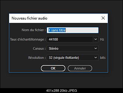

    p.s. btw, when I push the record button in Audition, I can select sample rate and bit depth to, but I don't understand why is the 32bit selected as basis, because finally, when the record is done, final bit depth is only 16bit (pls see this pic, it's the windows which opens when I start a new record. I can choose 8, 16, or 24bit, but it's always the 32bit which is selected as default, and I always set to this last one when I'm recording)...
