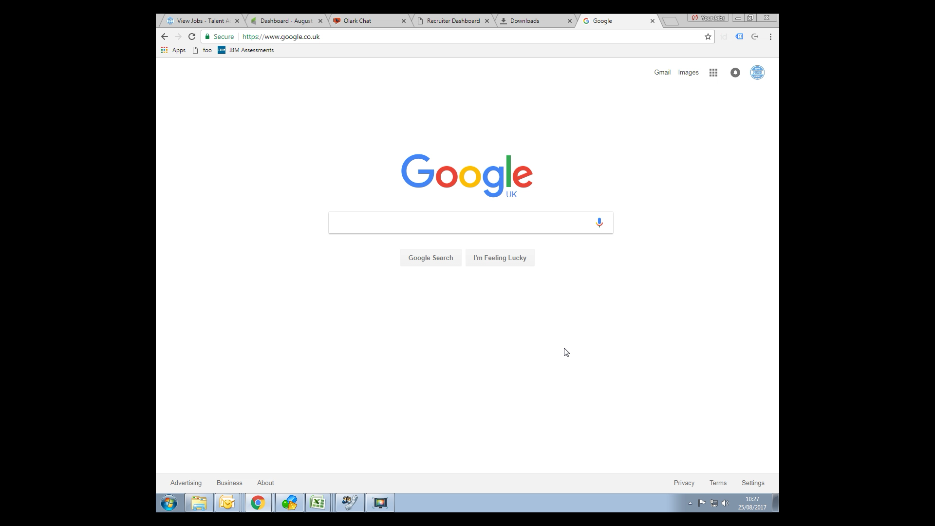

  3. I've uploaded 2 test videos doing exactly what I'd usually do.
    Here's the original capture (saved as PM4) - https://files.videohelp.com/u/271400/Original%20Screencapture.mp4
    And the edited (saved as HD video for Youtuvbe 1080p) - https://files.videohelp.com/u/271400/Edited%20Video.mp4

    If these videos are typical then there are several issues.
    1. The original capture has an odd display ratio of 1280*1024. Is that the dimensions of the display you are capturing ?
    2. The original video has a variable frame rate of +/- 30 fps. That could be an issue with he capture program but check its settings to capture at fixed frame rate.
    3. The edited video now has a fixed rate of 25fps. The editor is unlikely to correctly change the video from 30 (even if it was fixed rate) to 25. You should export at 30 fps which is closer to the original. But, again you really need to capture fixed at either 25fps or 30fps.
    4. The edited video has now been enhanced to 1920*1080. It appears that the original height has been changed to fit the larger frame. The width would also change to retain the odd AR of the original. That could make the original slightly fuzzy.

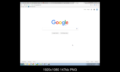

  7. You should add borders to the top and bottom instead of resizing the video to the height of the frame. That will prevent blurring from resizing.
    If your software doesn't allow that, or you just can't live with the top/bottom borders, use a sharper resizing filter. It looks like you used a bilinear filter. Using bicubic, or something sharper will give you less blurring.
    In the future use a computer with a native 1920x1080 display and capture at that resolution. You'll be able to avoid resizing and adding borders.
    And also have rec.709 vs. rec.601 color issues, and full range vs. limited range brightness problems.
